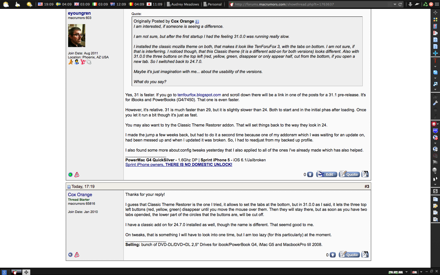

Yes, 31 is faster. If you go to tenfourfox.blogspot.com and scroll down there will be a link in one of the posts for a 31.1 pre-release. It's for iBooks and PowerBooks (G4/7450). That one is even faster.
However, it's relative. 31 is much faster than 29, but it is slightly slower than 24. Both to start and in the initial phase after loading. Once you let it run a bit though it's just as fast.
You may also want to try the Classic Theme Restorer addon. That will set things back to the way they look in 24.
I made the jump a few weeks back, but had to do it a second time because one of my addons which I was waiting for an update on, had been messed up and when I updated it was broken. So, I had to readjust from my backed up profile.
I also found some more about:config tweaks yesterday that I also applied to all of the ones I've already made which has also helped.

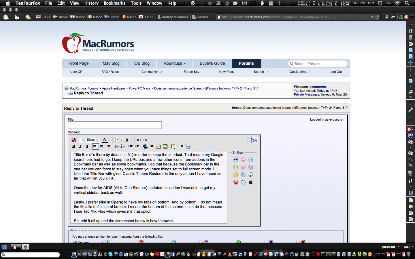

My preferred way of browsing is higly customized and it took me a while to figure this out. I browse using keyboard shortcuts. In previous versions of T4Fx I hid the URL box because you can call up a dialogue box via keyboard shortcut. However, if you hide the URL box in 31 it kills the keyboard shortcut! So, I had to move the URL box out of the Title Bar (it's there by default in 31) in order to keep the shortcut. That meant my Google search box had to go. I keep the URL box and a few other icons from addons in the Bookmark bar as well as some bookmarks. I do that because the Bookmark bar is the one bar you can force to stay open when you have things set to full screen mode. I killed the Title Bar with glee. Classic Theme Restorer is the only addon I have found so far that will let you kill it.
Once the dev for AIOS (All In One Sidebar) updated his addon I was able to get my vertical sidebar back as well.
Lastly, I prefer (like in Opera) to have my tabs on bottom. And by bottom, I do not mean the Mozilla definition of bottom. I mean, the bottom of the screen. I can do that because I use Tab Mix Plus gives me that option.
So, add it all up and the screenshot below is how I browse. P.S. The second shot is normal browsing mode (non-full screen). You can see that the traffic lights are normal. That's because I've killed the Title Bar.

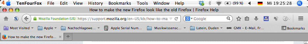

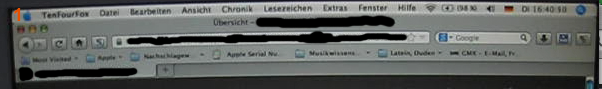

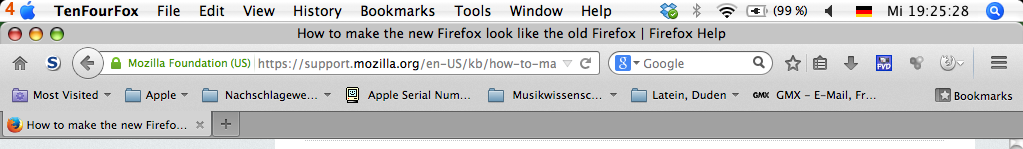

About 3-4 months ago I did something to 24.5.0 where I wanted to make it look like 3.6.28.
See 1st picture. (picture from camera, because I did a walk through video for my sister where I discovered the old design. Picture from July 27th, maybe I had been on 24.5 then, still)
Mind the rounded "backwards"-button. I think I installed this http://www.google.de/url?q=https://...QQFjAA&usg=AFQjCNEMrs0QsvvfXaA7UKxCBOq4flCu2Q
this was with 24.5 I think.

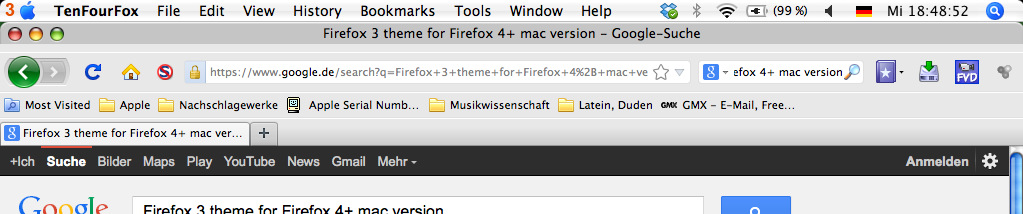

When I updated to 24.7 I got this: see 2nd picture. Mind it looks the same, but the round button seems to be square there.
I didn't notice it, I guess or I lost that round button after my last trials 3 days ago and have only now noticed.

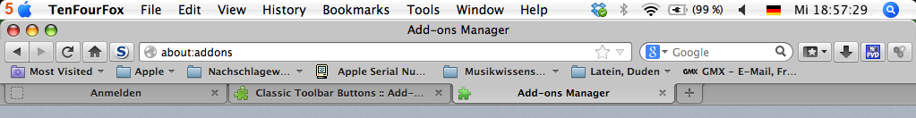

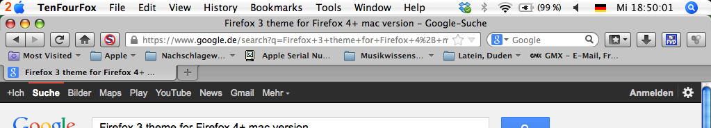

NOW, today, as I tried to apply the Firefox 3 theme for FF4 again on 24.7. and 24.5 I got this: see picture 3. (Mind coloured buttons, which I don't like, looks like windows.)

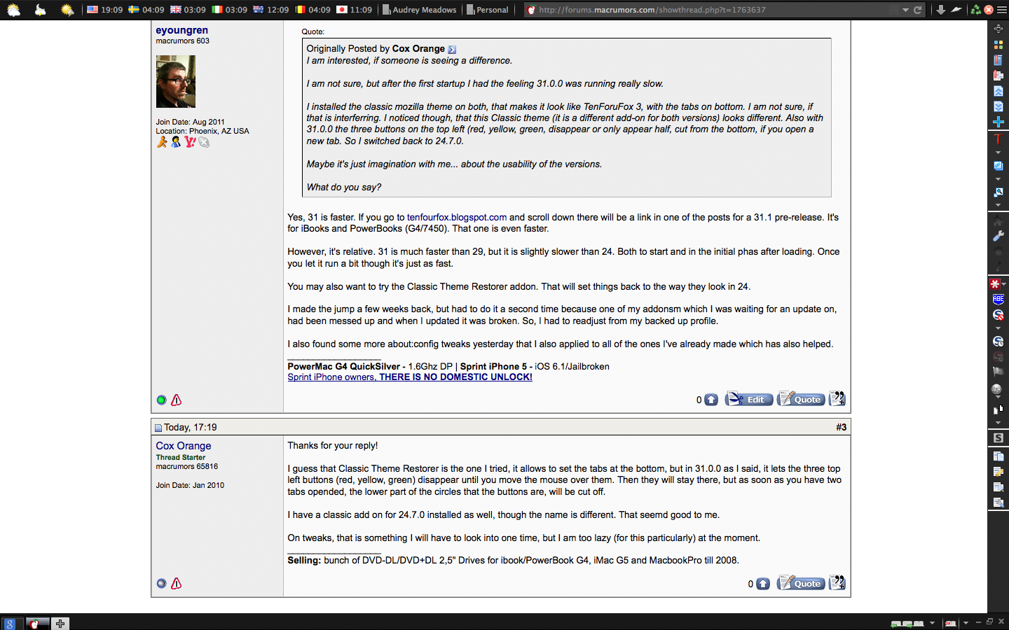

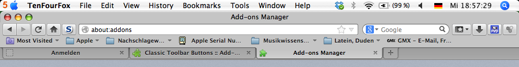

I installed 31 again today and just chose "tabs on bottom" from the menu and the three circles (red, yellow, green) are not cut off anymore, when using a second tab. I don't know why. Maybe I had tried something other additionally when I started this trhead and reported about the cutted cricles.
This is how 31 looks now: see picture 4

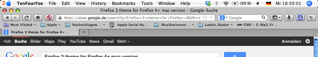

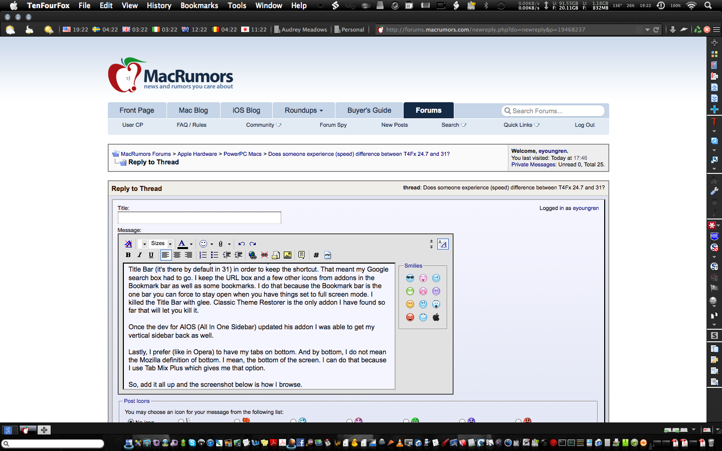

there is an add-on that's called "classic toolbar button", the funny thing is, for me it only makes the square buttons bigger. Useles for me. (see picture 5)
Edit: oh, also in picture 4 (i.e. 31) the colours don't match anyway. I would be just satisfied, if picture 4 would look like 2.
ON a side note, since I installed 31.4 and no "tabs on bottom" and let Clasic theme restorer do everything, I don't have problems anymore with disappearing traffic light symbols.
