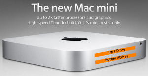

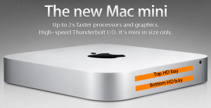

I think you have your bay locations confused.
The Lower bay is the one right under the wi/fi grill, the easy one to access, keep in mind when working on these bays your computer is upside-down.
Top=upper
Bottom=lower
It doesnt matter. check your sata cables
After poking around, all the complaints i saw were users who used an iFixit data cable, and the consensus was that the problem was specific to that particular hardware, and was fixed every time by changing the drive positions.
