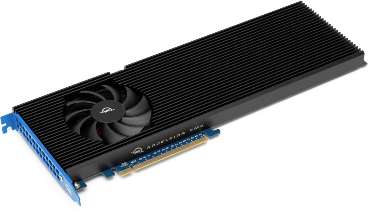

other option is to buy a dual SATA-III 6Gbps card from:
or single SATA from OWC
SATA-III is limited to 600MB/s BUT.... 8TB SATA from Samsung QVO or Micron, is cheaper than 2x4TB M.2
or if you like Both at same time, Speed + Big Size.
buy the dual U.2 PCIe card, the card is cheap, but the U.2 drives are very $$$.
if you want 4x M.2
OWC
if want 8x M.2 PCIe 4.0
OWC
