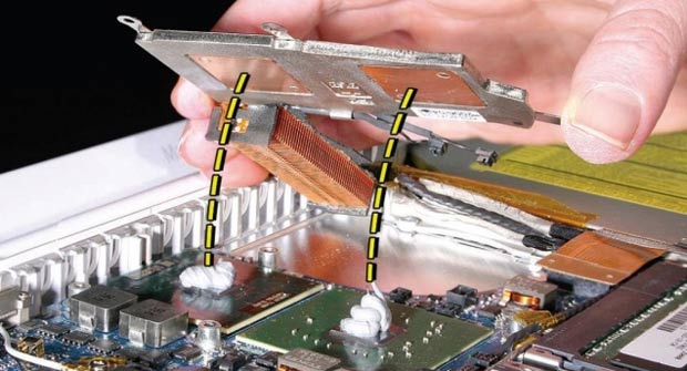

regarding thermal paste... properly applied high quality thermal paste should not need to be reapplied. however.... too much low quality paste is usually applied at the factory and it will actually insulate more than fill the microscopic gaps in the surfaces as it is supposed to do.
also, the person that made this photo for the apple service manual has no idea what they are doing...
Good grief! How much is he using????? Paper thin across the processor for crying out loud, or a blob half the size of a grain of rice in the middle and spread by the heatsink pressure, not something the size of a hazelnut.
Good grief! How much is he using????? Paper thin for across the process for crying out loud, or a blob half the size of a grain of rice in the middle and spread by the heatsink pressure, not something the size of a hazelnut.
That photo is horrifying.
