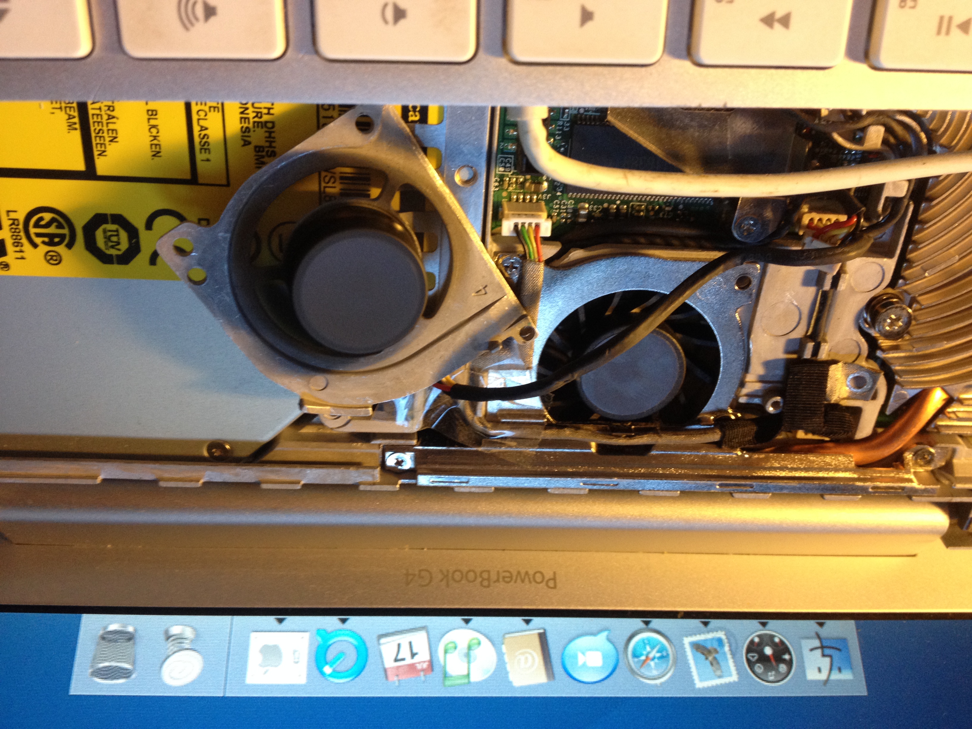

So I just got done doing a logic board swap from a parts 1.5 machine into my 1GHz machine, however I have yet to see the fan turn on (running without the top case to make sure everything is working) but the fan is still off. I checked connectors and everything.
I ask because the fan was on 24/7 with the 1GHz logic board, so I'm lost!

Just tried the fan from the 1GHz and still doesn't move. Maybe the thing just isn't hot enough yet, has some new Artic Silver 5 under it!
Got it to spin! Just required opening up every app on the dock.
Stupid thing, the picture uploaded upside down.

Yup, as you can see the fan only turns on when it needs to. I don't understand why Intel Macs don't do this. Intel Macs have a base speed and are always running. I made a thread about it but never got a real answer.

It's been so long since I had a PPC that I thought that they did the same thing! My earlier post is now discredited 🙂

One YouTube video is all it takes on my 12" 1.5 GHz PowerBook G4. In fact, during normal use and after it warms up the fan is almost always noticeable.

It's a virtually inaudible 1000rpm, the hard drive motor was more noticeable than the base fan speed on any of my three HDD equipped MacBook Pros.
Badly coded crap like Flash would spin them up pretty rapidly at which point they were audible, but that's not been an issue since 10.6/HTML5 etc.
Spinning them constantly, plus gradually ramped speeds reduces temperature spikes. It's also far less distracting than the on/off/on of the TiBook for example.
