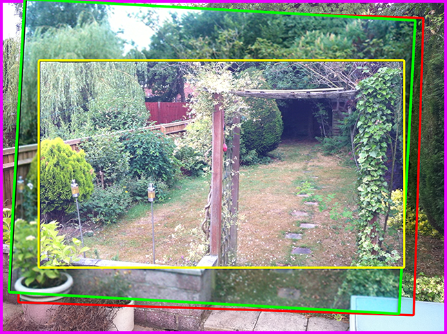

This IS an issue, I just think you don't understand what people are saying here.
Please see the attached composite picture I made showing the problem:
The colour coding is as follows:
Purple iP4 Still image
Red 3GS Still image
Green 3GS video
Yellow iP4 video
Although as you correctly point out, the YELLOW iP4 border is a 16:9 format, the frame is still horizontally narrower than its PURPLE still image frame.
Ideally, the width should stay the same and the top and bottom areas are cropped away to give the correct 16:9 ratio. (see second image)
As it is, Apple have cropped all four sides so this IS an issue
On the Apple forums, the reason somebody came up with was that the resolutions for the iP4 video and still recordings were different.
This is not a reason because the resolutions are different in the 3GS but the horizontal field of view remained the same in both video and still image modes.
I started to think that maybe the sensor area was chosen so that as little processing as possible was needed in order to get the exposed pixels into a 1280x720 video stream, but that doesn't work out either:
1280 x 2 = 2560 and the full width of a still image is 2592 so Apple would have been better off using almost the entire width of the sensor (less 16 pixels each side) to gather the light and then mapping every two pixels to a single pixel for the video frame.
It definitely isn't just a 1280x720 crop as you can see from the green border in the second image.
Maybe a software fix is imminent for this as well as the white balance?
That's actually a really good idea. It sounds like it would improve the video quality even more. 😱
I hope Apple finds a way to do that and implements that fix (along with a proximity sensor fix) in the next patch.
I care about that way more than I do about free bumper cases.
I hope someone makes a petition asking for that.
It actually makes the video worse. It leads to visual glitches and distortions and is one of the reasons why SLRs have only now started to produce decent video despite the fact that they've had better resolution chips than video cameras for many, many years. They've had to overcome the fact that their chips were better than video cameras. The iPhone seems to solve it by just avoiding the issue in the first place and just taking what it needs from the center of the chip.

"What's interesting is that the iPhone 4 appears to crop the sensor down for video recording, taking the center most 1280x720 pixels instead of scaling down the entire image size. The result is that the focal length for video recording is notably longer than when taking photos." "...Perhaps the A4 SoC lacks the compute power to apply a scale and encode at the same time, necessitating this crop."
