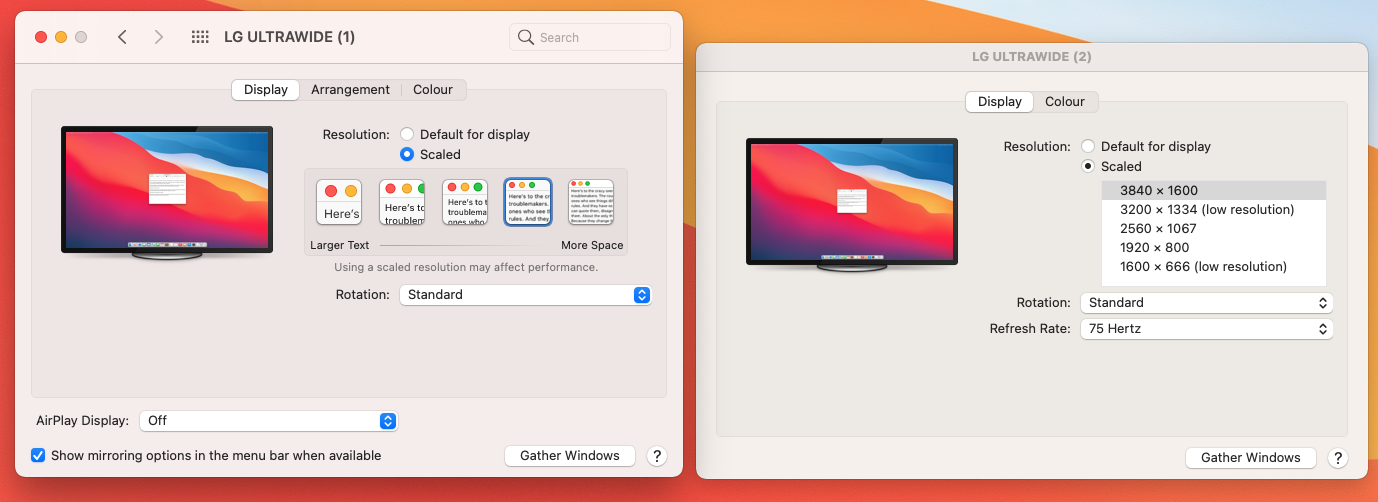

I have the LG Ultrawide 38UC which is the previous model I think (although apparently fundamentally the same - same panel / Case etc.).
It works perfectly but with one caveat - if you use HDMI, there is no 'scaled' mode' (retina) at 3840x1600 as there was with the 2018 Mini + Catalina (you have to live with the tiny menu bar & tiny system fonts). If you use the USB3 connection you have the 'Larger text -> More Space' scaling options (retina mode) that give you larger system fonts etc. at the native resolution.
USB 3 Connection Left - HDMI Connection Right
