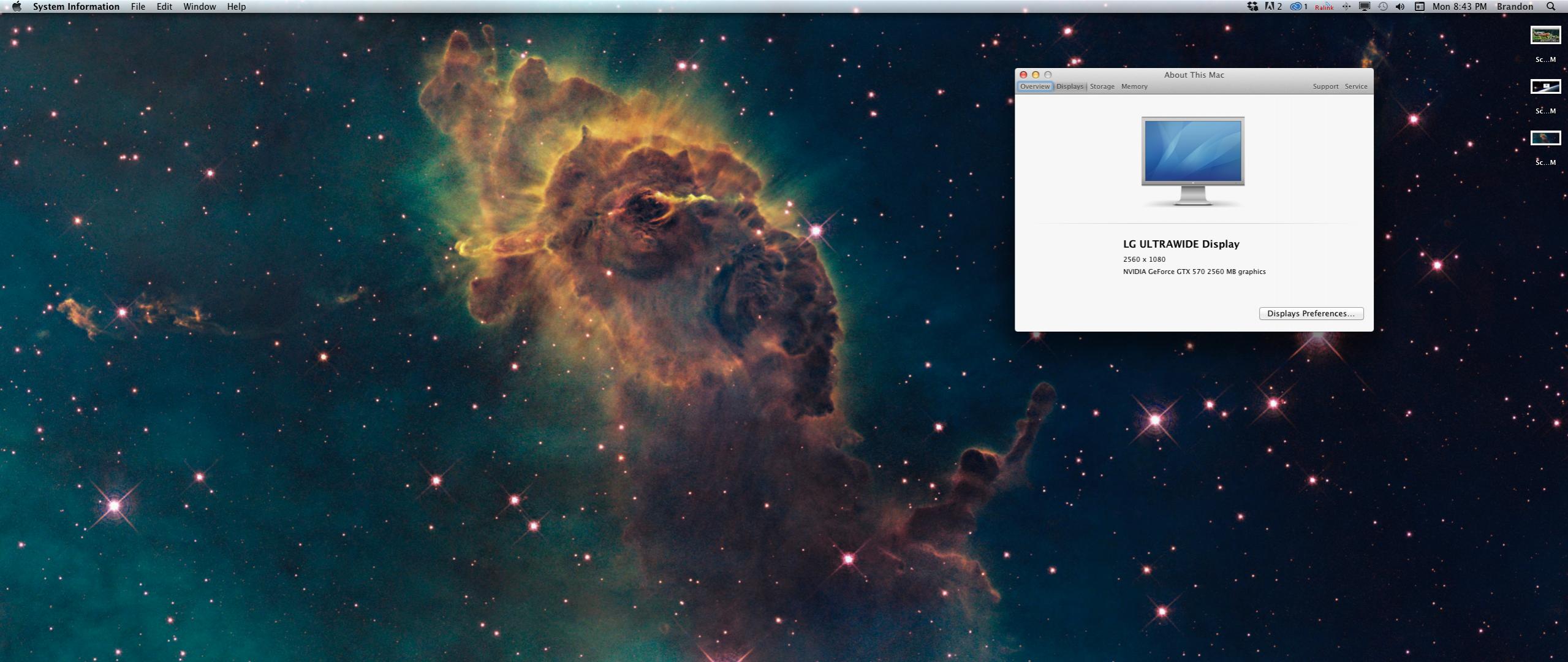

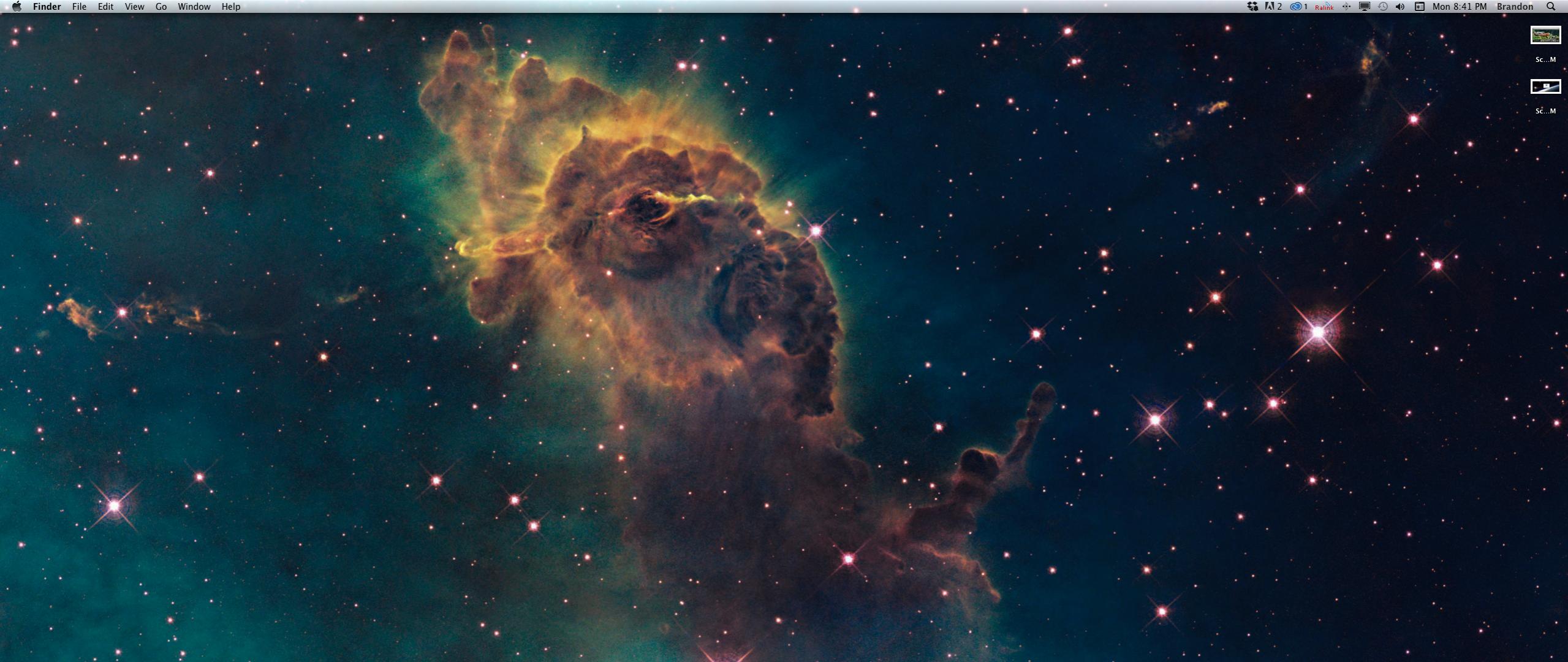

It seems that I was basically given innocently bad info. I was just wanting to be cautious. I was actually able to grab a GeForce GTX 570 at a good price. I put it in and it works great. Runs my LG 34um65 at 2560x1080 perfectly, and looks great.
Thanks for the comments!
