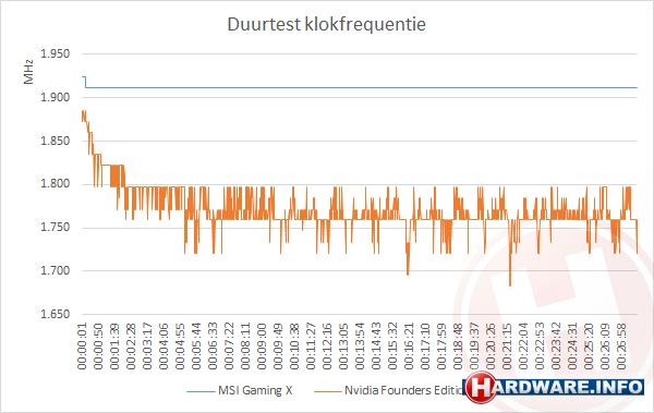

The card won't drop below the base clock, but it seems in reviews that it cannot keep a steady clock while under load. See here compared to a MSI GTX 1080 Gaming X, the founders edition spikes over the whole place where the MSI stays stable. In this test they looped F1 2015 benchmark 17 times to get to a duration of about 30 minutes.
