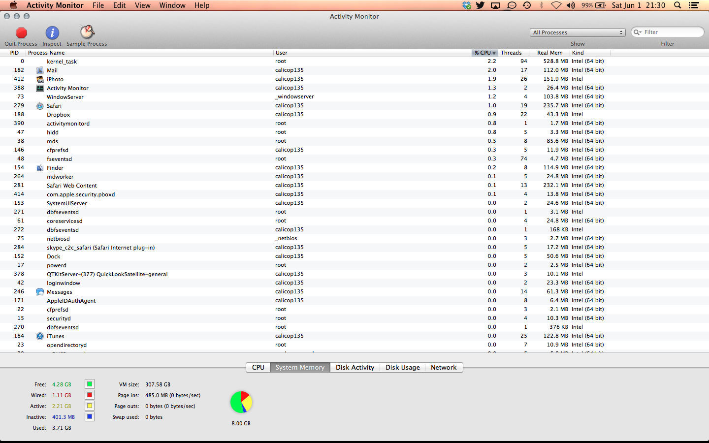

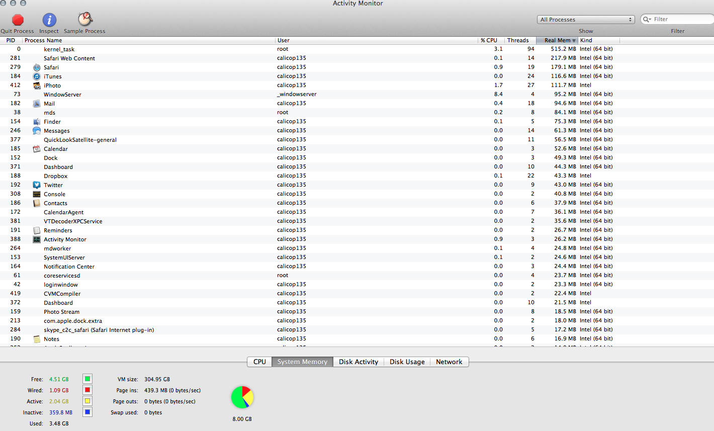

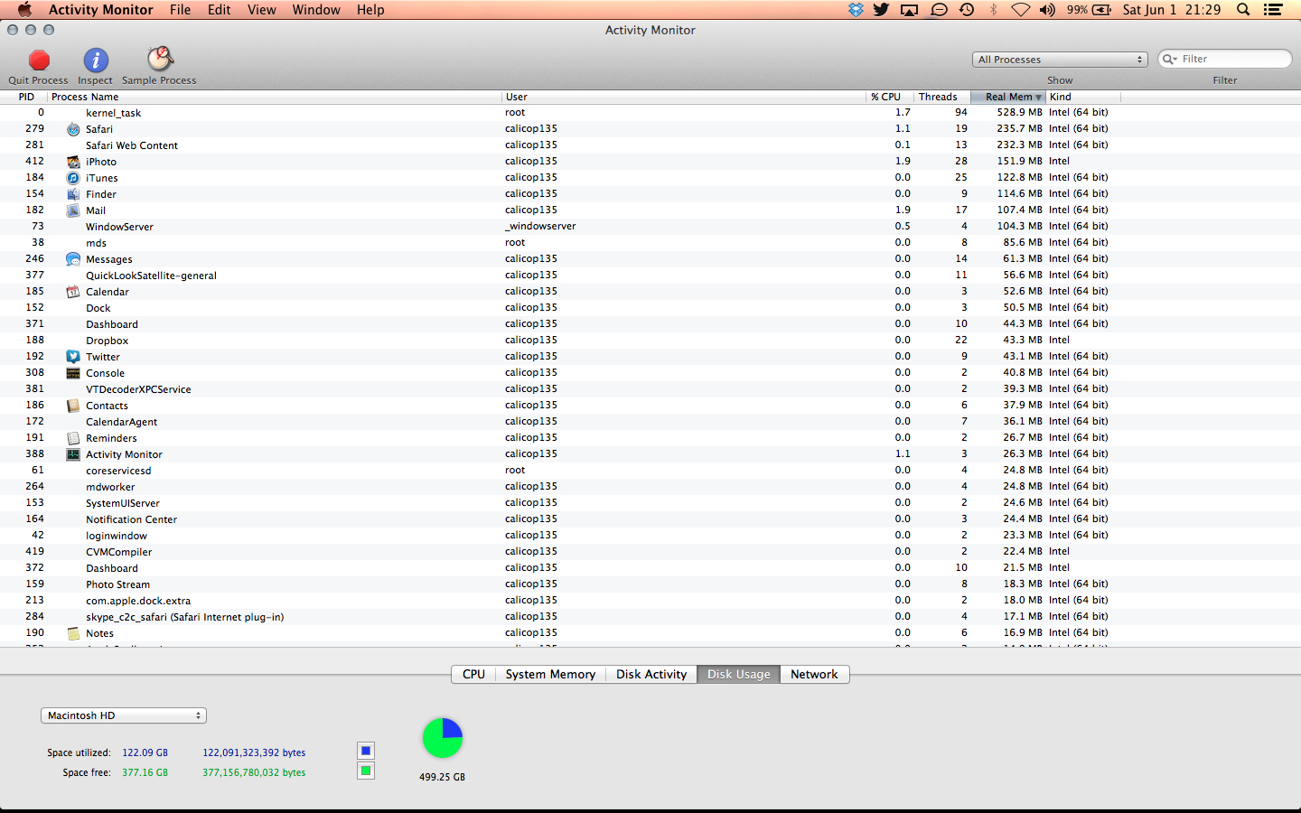

I hope these come through...I am trying to attach screen shots of the Activity Monitor

Everything looks fine here too. Strange that you're getting beach balls. Try fully quitting some applications, like iPhoto and see if that helps.
I assume that you're running all the latest updates from Apple?
As a shot in the dark, try resetting PRAM and SMC. Also try rebooting into safe-mode and then restart normally.
