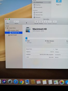

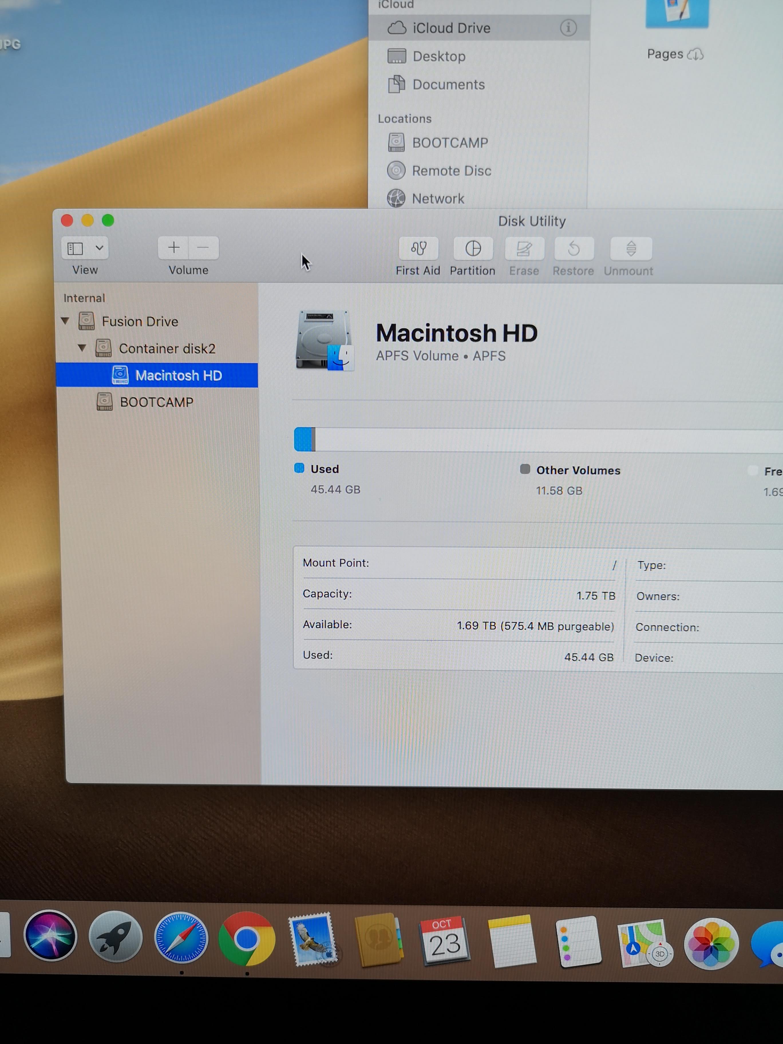

After my recent troubles with my mac and after help from an apple tech, my fusion drives became separated and I did a few commands in terminal to fix this, can you look at the picture below to see if my HD set up looks right?
Anyone ? I get the feeling there's still a problem as my Mac still isn't running as fast as it did before moving to Mojave
Looks fine to me! One fusion drive, one APFS container disk.

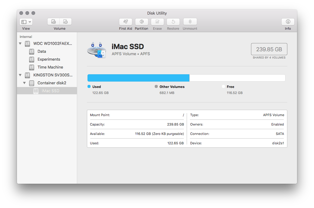

Also, CMD + Shift + 4 lets you take screenshots of individual windows, so you don't have to snap a pic of your screen with your phone. It always ends up looking funny 🙂
