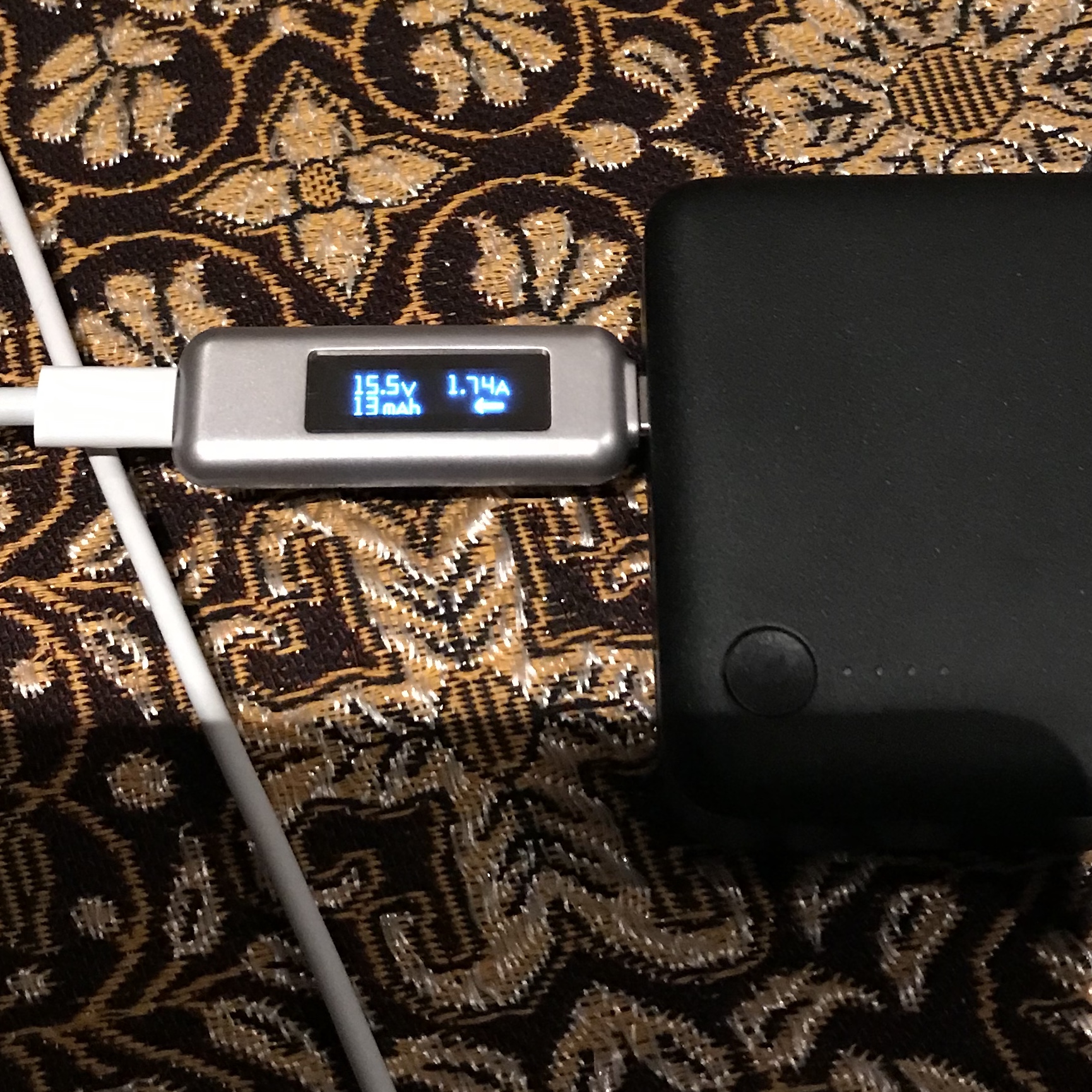

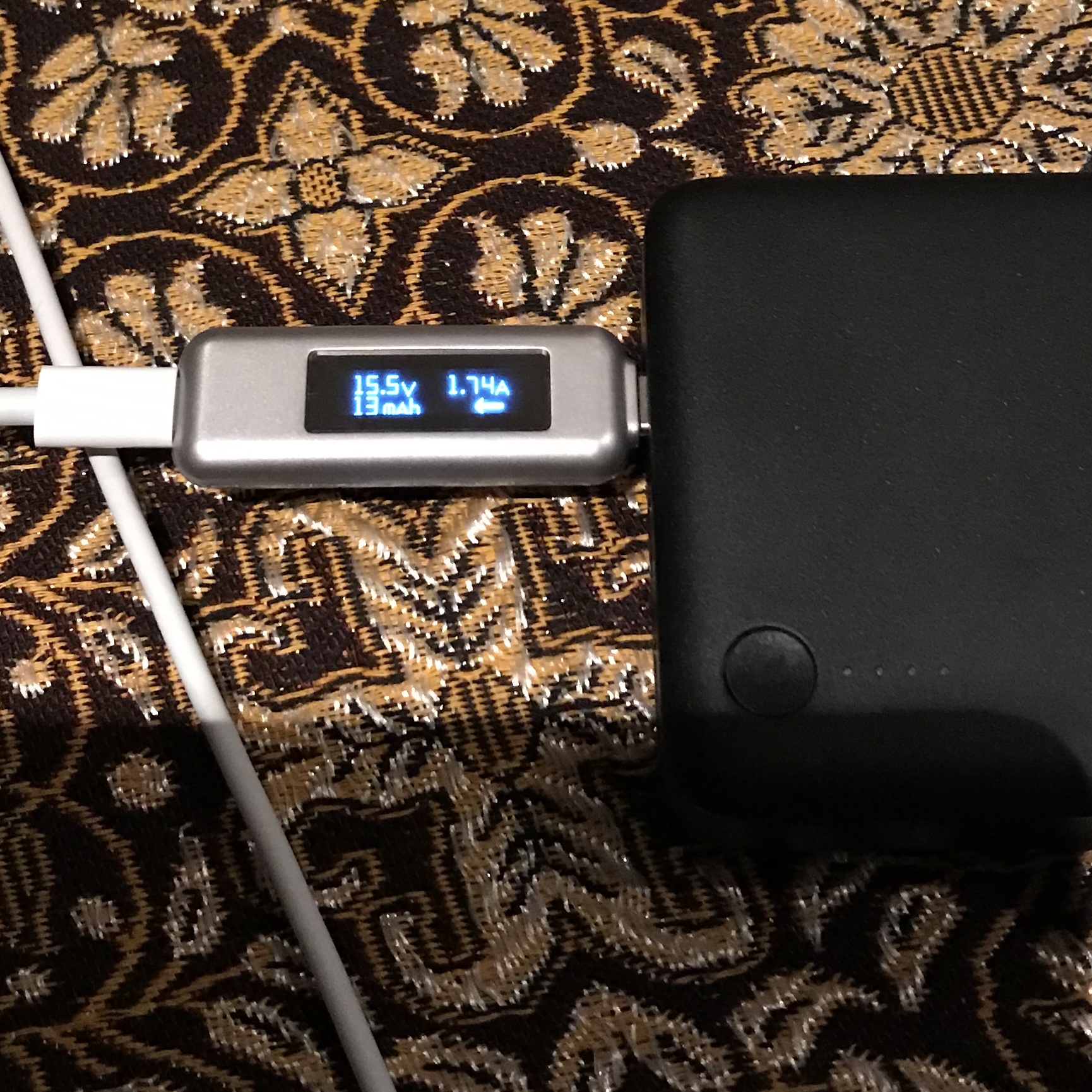

thats because Apples not following the true USB Power Delivery spec.
I have this exact battery pack and it fast-charges my iPad Pro 10.5 using the official Apple USB-C/Lightning cable.
My power meter shows 15.5V supplied and a current of 1.5-1.8A (see pic), ie up to 29W.
The battery pack also recharges at 14.5/2A using the Apple 29W adapter.
That’s awesome thanks so much for the test 🙂
Can’t do better than that a test of the exact battery pack, the exact iPad Pro model and a screenshot of the voltmeter
