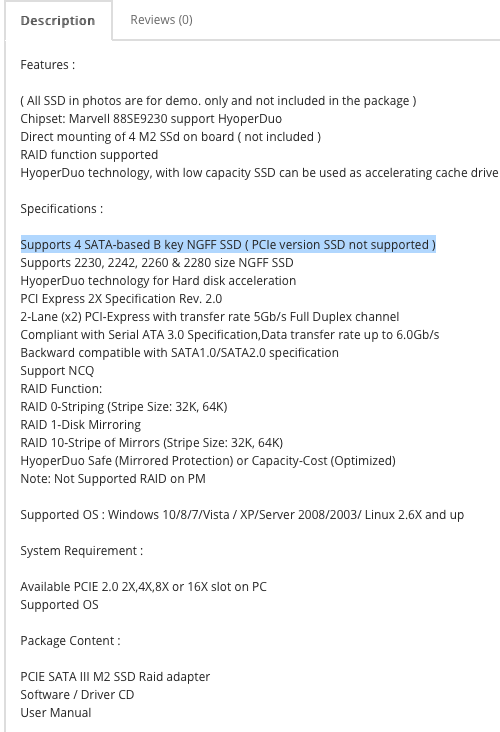

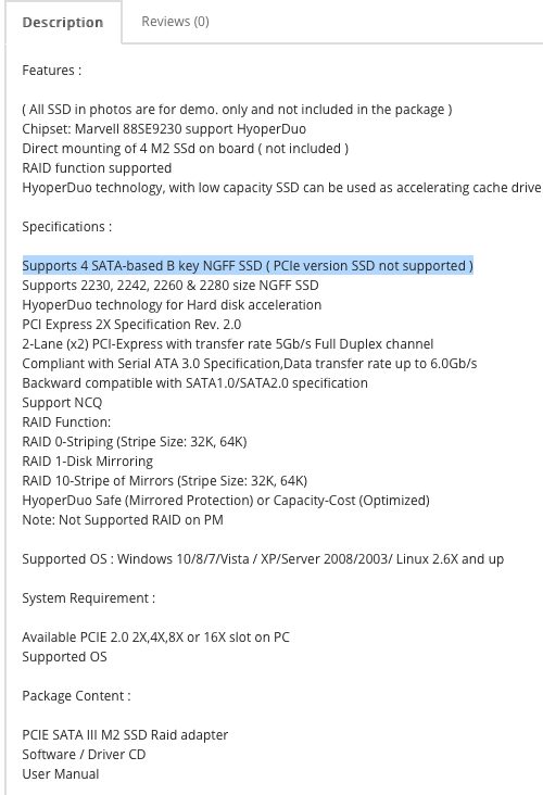

Do you noticed that this card only accepts SATA M.2 blades, no?
Yes, and it's not ideal. Looking at some options to replace Apricorn Duo X2 PCIe adapter (holding 2 x 2.5" SATA SSD). Have access to several Samsung 850 SATA M.2 blades and was wondering if OP was able to get the two blade version to work, if it was even purchased (do not believe it was).
