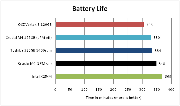

I seriously, seriously doubt switching one SSD for another would make roughly an hour of battery life's worth of a difference. That's just crazy-talk. These things don't draw that much power.
That battery test must be totally borked in its methodology.
The reviews clearly show there can be more than 1 watt difference. The total power draw of the MBP 13" can be around 7 watt if you turn down the brightness and disable bluetooth. If the total battery life is about 7 hours, then 1 watt less will result in ~1 hour more battery life.

Crucial M4 has lower idle consumption. If you want to reach max. battery life during low intensity use the M4 will do better than the Vertex 3.
I can confirm this myself, I got about 1 hour more with the M4 than with Vertex 3.

Tomshardware also showed huge difference in battery life between SSD. Noticeable the Intel X-25m was very easy on battery life.
I don't think this benchmark is wrong because I have seen the same in other benchmarks.
