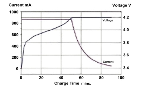

These are all max currents. The iPhone can handle more than 1 amp of current when it's fully depleted so it will charge faster with the iPad charger. But as it gets charged/full, it draws less and less current so for a topping off charge, I doubt the charger makes a difference.
Here's what the current draw looks like for a LiPoly 4.2 V battery charging:
