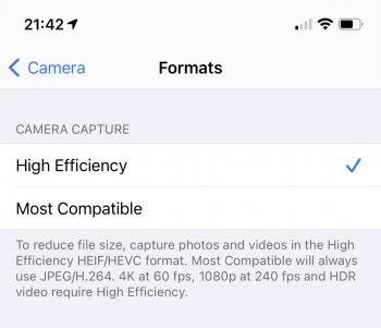

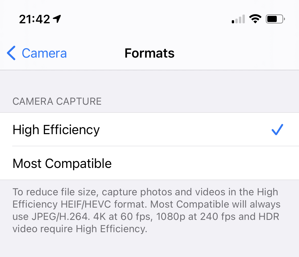

under Settings > Camera > Formats, do you have High Efficiency turned on?

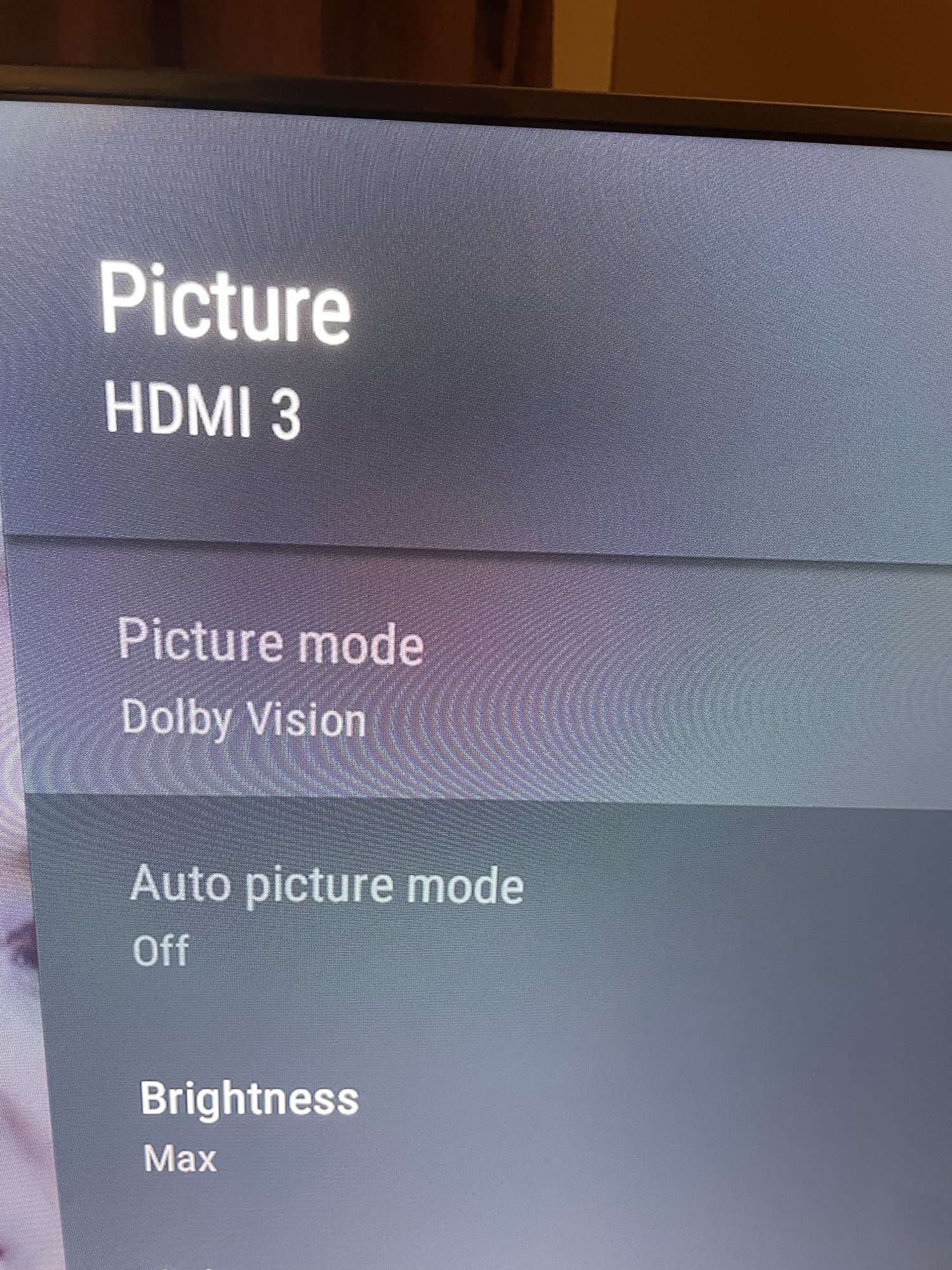

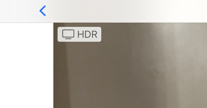

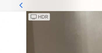

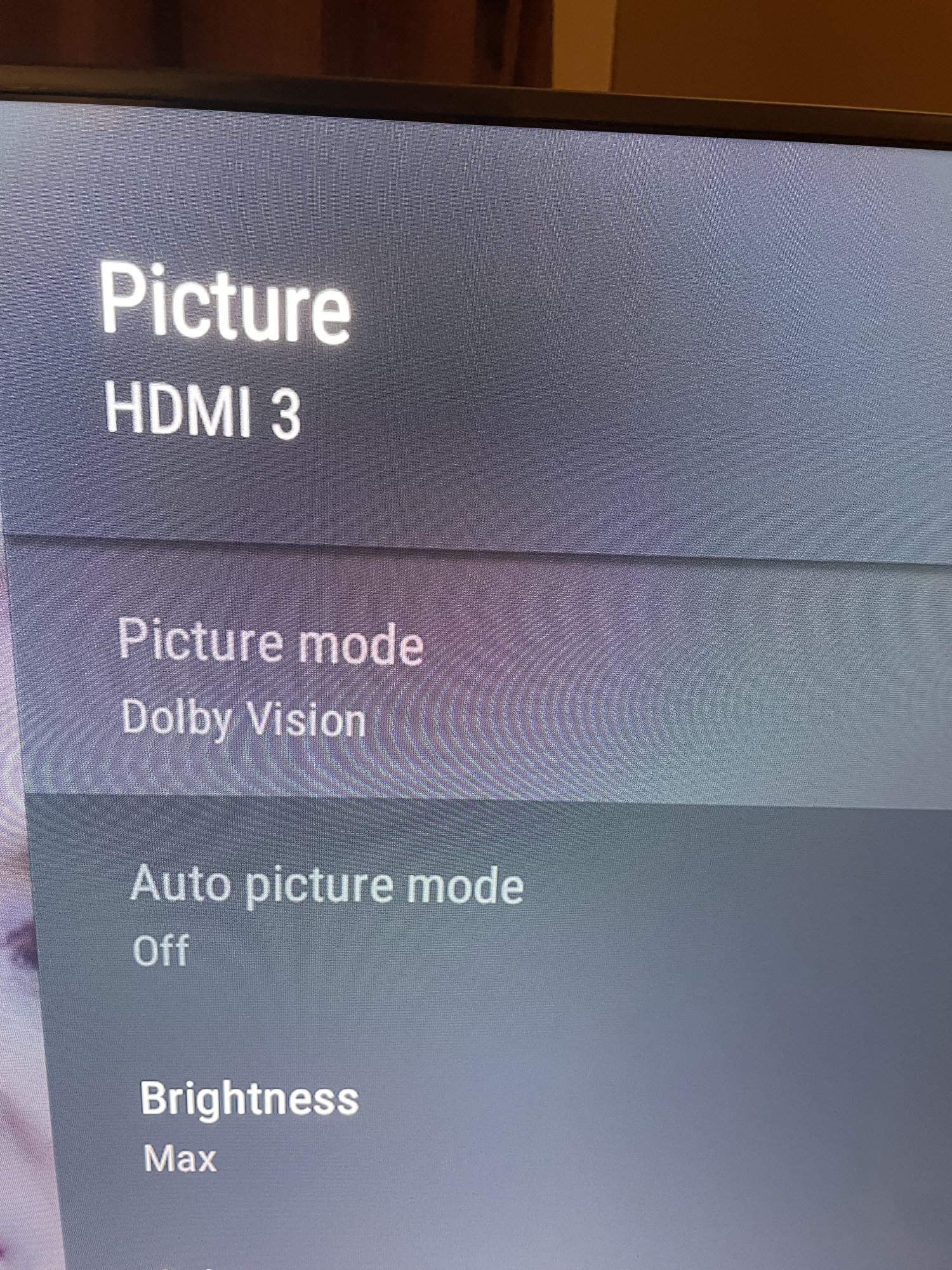

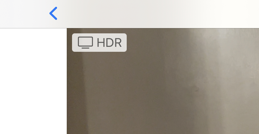

Ok. Will try shooting a quick vid here and see if I get the same result via AirPlay to my ATV 4K > DV capable Sony X9005F TV.
Just tried - all works (although this only proves that my setup works). Playing back the video on the phone shows the HDR badge in the top left and when AirPlayed to ATV 4K, the Sony TV shows the incoming signal as Dolby Vision encoded.
You don't have the ATV set to 4K DV, do you? It should be set to 4K SDR with match range and match frame rate turned on. That way it will only trigger DV if a DV feed is sent. If you have the ATV set to 4K DV, is it will send everything as DV, no matter what.
