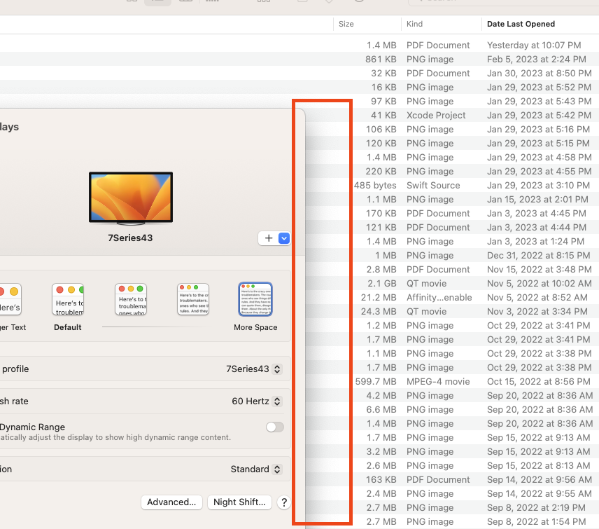

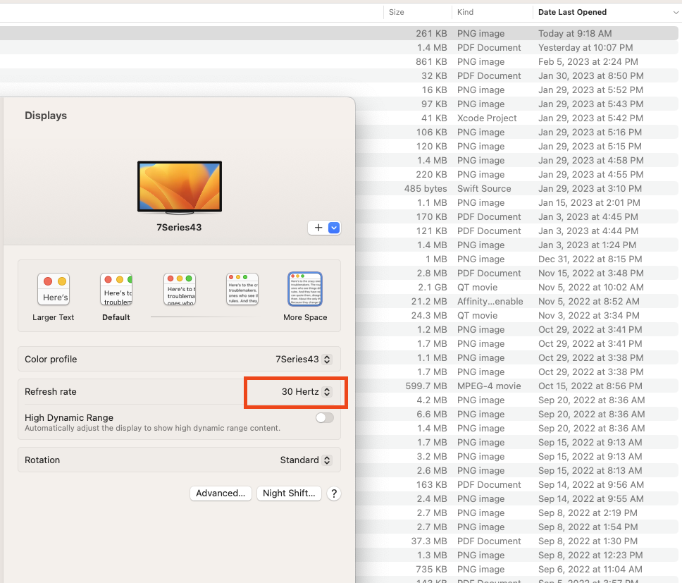

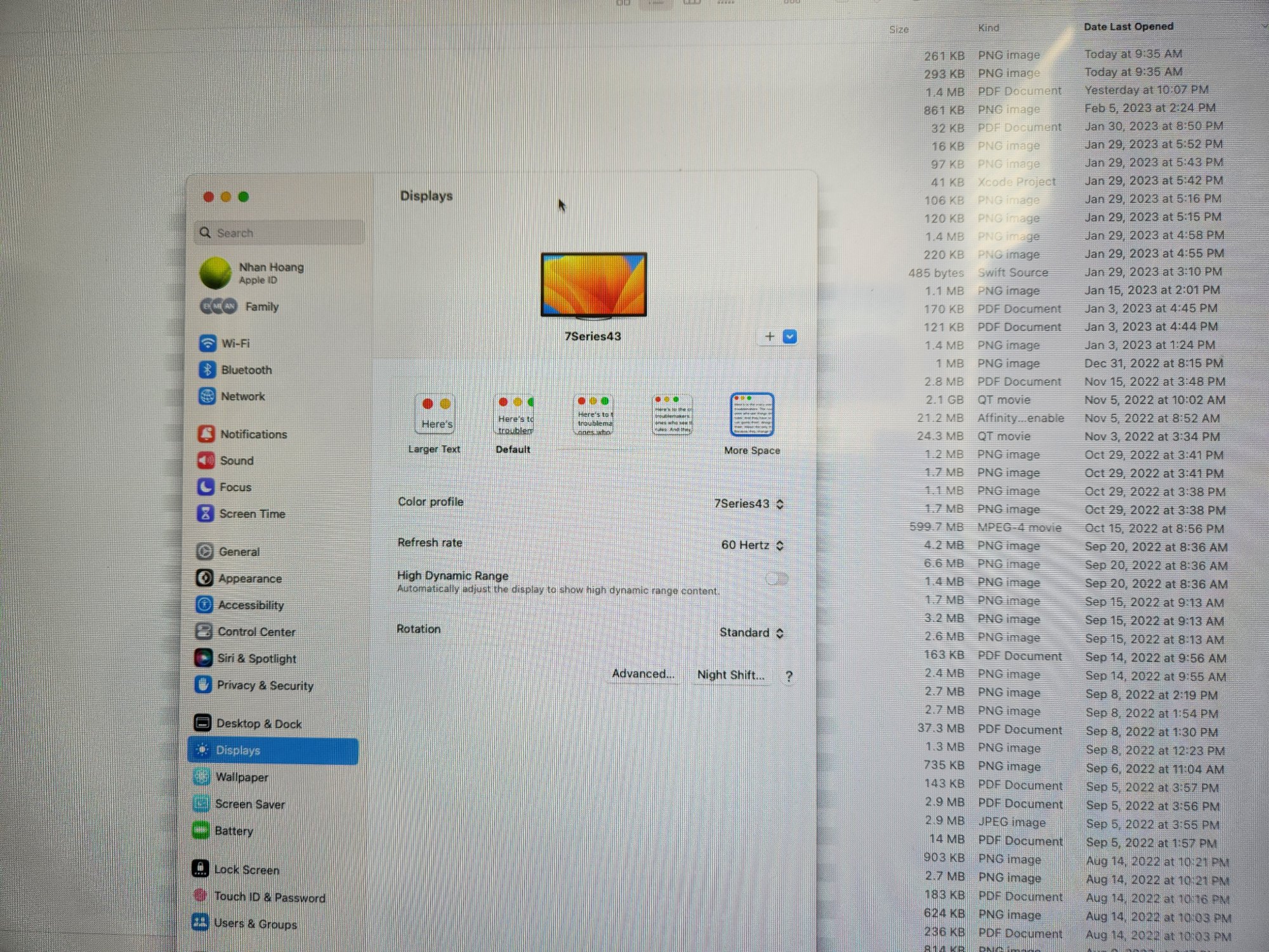

I recently purchased a CalDigit SOHO and it outputs 4K60 through HDMI with my M1 MacBook Air, but with a peculiar problem. In 4K60 it fails to display the alternating white/gray rows in Finder, but looks proper in 4K30. Has anyone else experienced this with 4K60 on their hubs/docks? If so, is there a fix?
I am not sure if the issue is with my 4K TV or the signal being passed through from the MacBook Air. When switched to 30Hz I see the white/gray rows in both screenshots, but when set to 60Hz I actually don't see the alternating row colors in either desktop screenshot and it looks like the photo from my phone.
EDIT: Figured out the issue -- the 4K TV I use as a monitor is a budget/cheap model and is clipping the highlights. I finally realized this after using a calibration disc, and comparing it to our Sony 4K TV in the living room. I previously tried different HDMI cables but still had the same issue. I then connected the CalDigit and MacBook Air to our better Sony 4K TV in the living room, which I know can do HDR, and everything looked correct in 4K60. Case closed.
