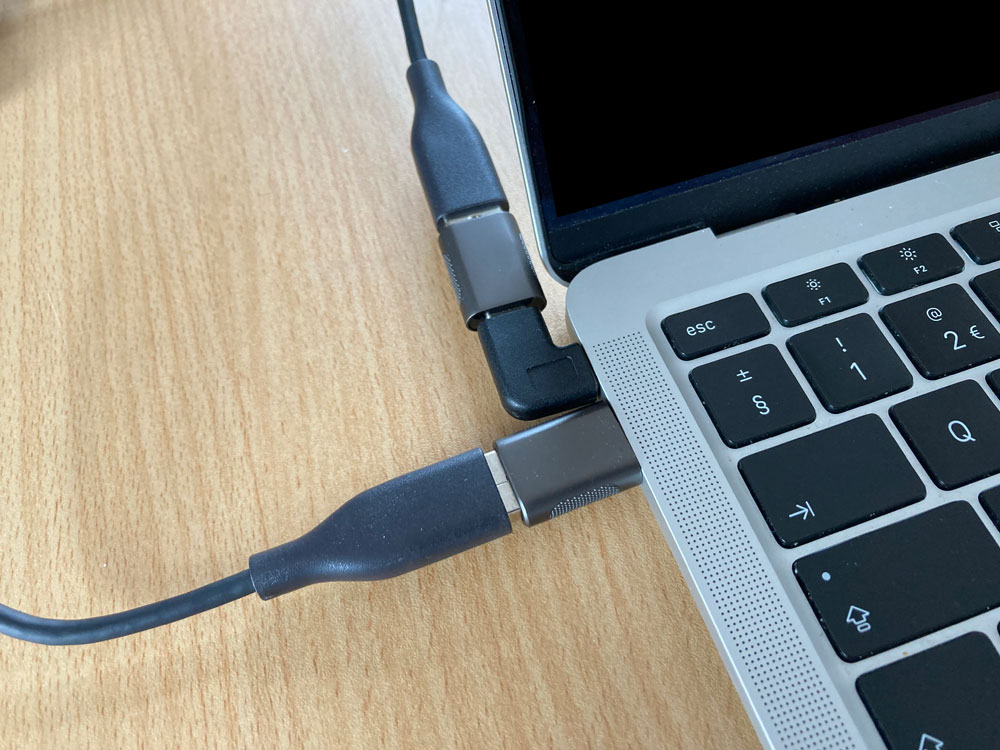

As an Intel MacBook Air owner, and as someone working with large video files which need to be backed up (and the backup also backed up), I frequently run into the nightmare shown below. To back up from drive A to B it takes up both ports and leaves me with no power and often the backup takes longer than available battery even at 100%.
I know you can get USBC to hubs with multiple old USBA sockets in... but... as I am now moving over to Samsung T7 SSDs which are USBC, I can't find any USBC to multiple USBC hubs anywhere (am I being thick? they all seem to be USBC to USBA, or, USBC to a load of ports I don't need). Is there a USBC hub that simply provides multiple USBC ports, shaped like on the Air, but will leave one of the two on the Air free for power? That's just USBC - not USBA or SD card or HDMI (the ones on Amazon only seem to have one USBC).
Am I right in thinking I'd get half the transfer speed too, from device A to device B but via port A (rather than device A on port A to device B on port B)?
Or has anyone got any other suggestions?
The photo below shows my old Western Digital HDD drives which are the old USBA and if I don't use a hub, we have mindbogglingly silly dongles and right angled adapters so it all fits 🙁 As a former 2010 MacBook Pro owner this is such a step back (and yes, before the suggestions that I need a better MacBook with the ports required, I can't afford that as an option at present).
H E L P ! ! 🙂😀

That cabling is a seriously stupid way to handle the issue! True, a pure USB C hub would cleanup things at the computer, but it alone wouldn't fix this stupid mess of cables and adapters.
The "correct" approach is to set aside all of those cables and adapters and replace the two cables with proper USB 3 microB to USB C cables, whether you connect directly to the computer or through a pure USB C hub.
Reactions: Larsvonhier
Thanks so much for the Caldigit suggestions... the Soho looks ideal because as stated above it essentially allows me to plug a drive into my Mac whilst passing power through too, and it doesn't have its own PSU so is small (I'm very mobile in terms of where I work). But an added bonus is the SD card readers, which means I can bin another dongle. Amazon reviews are a little mixed though.
Yes, you have made me feel "seriously stupid" about it 🙄

I have not decided on hubs yet, but my "micro B" to USBC cables (as suggested above) arrived today and these are great, this removes the USBA to USBC dongle, the right angle adapter when plugging two in, plus makes the whole thing more stable to movement!
Thanks again for your help on this. As for hubs, the more I think about the advantages of these when plugging/swapping drives etc the more I think I'll benefit from one. Today I was swapping a card reader with my video files on, with the T7 SSD for editing, and an older HDD to get some older footage, whilst having to keep the power connected as battery was low. This would all be easier on a hub.
My next Macbook will definitely have magsafe to free up some ports!
Cool. Have you tried to benchmark the new cables vs the old usba?
I'm just curious if you'll see a speed increase. I did, even though, theoretically, it seems like you shouldn't.
