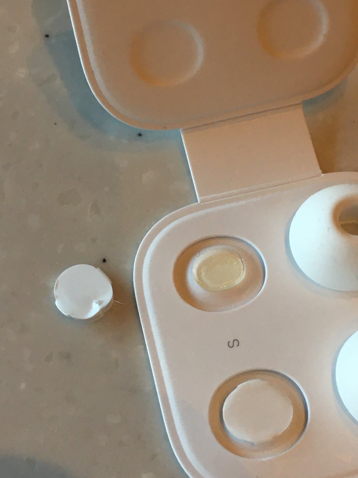

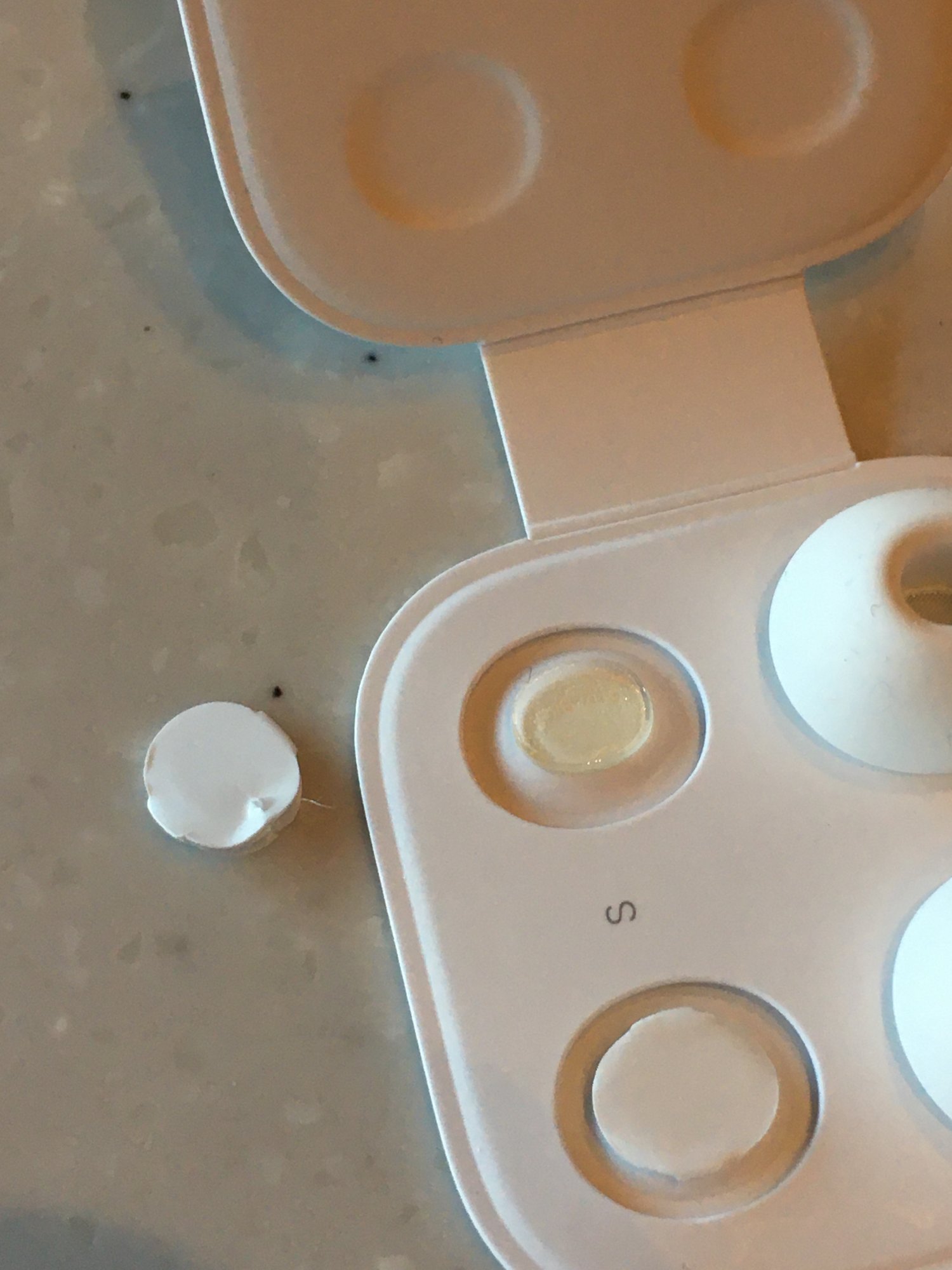

I wanted to try the small size, so I swapped them with the mediums. I put the mediums in the paper case where the smalls came from. The four possitions are all the same size.
Then I needed to swap them back because the smalls were too small. I'm glad I realized what went wrong; a paper tab that holds it came undone and got stuck inside the Airpod. I only noticed it because I couldn't get the small back into the paper case.
I couldn't get it out, and I came very close to pushing it out from the other side when I discovered there's a little screen in there to keep gunk out of the speaker. Had I pushed it out, I would've broken that sreen. So I used a little pin to remove the tab. I suggest you not re-use the paper case as this is likely to happen. I wonder how many will use their Airpods with a tab in there and not know it.

I recall one review on YouTube mentioning this. Seems like very poor packing of the tips. Wouldn’t be surprised if there are people not happy with the sound due to this, which would be a real shame.
This happened with two of my pods. Well done for highlighting it. I only realised because I couldn’t get them to click in.
Weird! I have swapped back and forth between the small and medium tips about four times, so I guess I’m lucky that never happen.
Yep, happened to me with one of the large tips. I actually did puncture the membrane poking it out as I didn't know at the time it was there.

I can't tell if the hole is effecting the sound so am still using it, in just a bit worried about moisture/ear debris getting through.

It should be a screen that air can pass through but not wax, etc. It shouldn't be a membrane... I wouldn't worry about it at all.
Really, though, a missing or skewed or punctured screen will have no ill effects on the function of the tip... it's just that some crud can pass through to the speaker surface.. if it's skewed, use a pin to straighten it out... if missing, I'd want to replace it within a month to keep the speaker clean, which brings up another point -

WOW! I was about to process a return online today because they had literally NO volume at all, I take them both out as I have to use the large tips and both of them have the paper blocking them. Thank you so much, they are now almost too loud.

How many people is this happening to and they simply don't know the cause? It is ridiculous that Apple's own system for storing these can lead to this problem so easily. I bet there are lots of cases where volume is out of balance, it fails fit test, ANC doesn't quite work, etc, all because of a stupid hanging chad stuck inside, a white thing difficult to see against a white bud.

Lol it happened on the larges because I curious what the fit test would say. I didn’t notice until I put them in and noticed the right ear sounded muffled.
It’s because people don’t realize the tips only fit one way as they are oval shaped not circular. That’s the only reason why yours ripped off.
