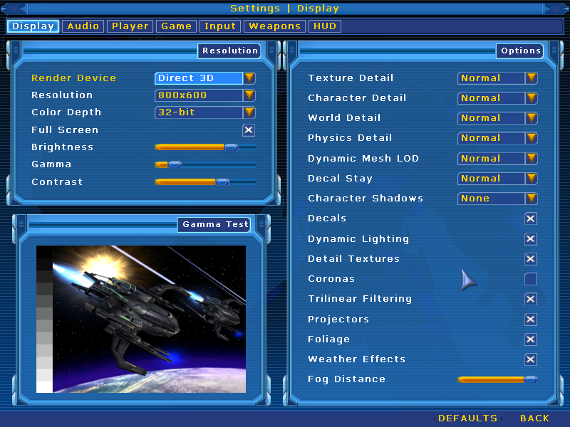

milo said:
Nice results on Unreal, did you notice if it's using both processors?
Hard to tell if it is on both processors, take a look at the attached settings image. Is windows swapping cores or am I severely GPU-limited? Do note that the 46 FPS average is on an indoor map and it matters greatly. The FPS indicator is very often in the 50FPS+ region.

I get rather high framerates on all settings, which surprised me. Note the odd thing that some higher resolutions get higher FPS then the lower ones which I can't really explain. The medium settings were the same as before. The highest quality settings were those as can be seen in the attached image (I could set nothing higher). I wondered if these settings were correct, since I recall lower framerates from the first time I played it, so I played a internet game ons-toran @1280x1024 (highest quality). The FPS was lower then the botmatch. The indicator dropped sometimes to 13FPS but was very often in the 20FPS region. Regardless, the game was very playable and I was not bothered by this performance.

Just look at the attached images of the settings screen. That are the setting I used for medium quality and highest quality.
