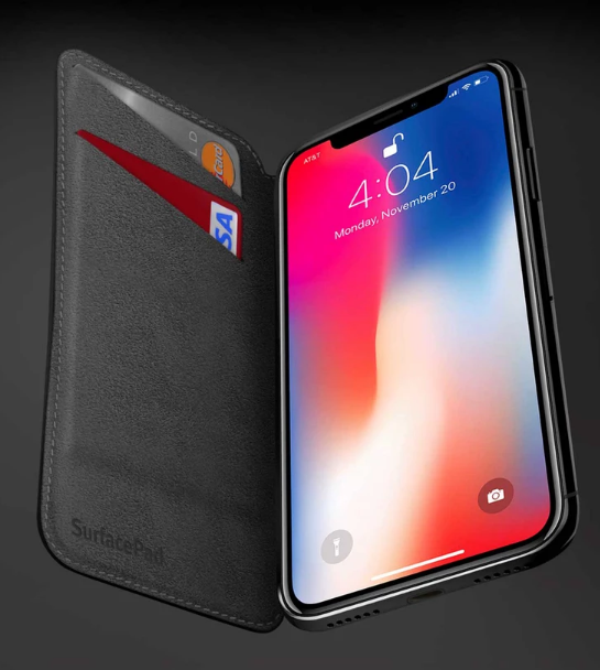

I have 2 door passes in my iPhone XS case/wallet (Twelve South Surface Pad) - one door pass is to gain access to my office building and the other activates the elevator up to my floor. These are both stored in the front left flap of my case (as in the below pic) :
When the flap is closed, I can use the cards through the flap (without the need to remove the cards) to activate the door and also the elevator however, sometimes, Apple Pay also activates as I touch the case/phone next to the reader??!

It's because the technology used for contactlessly paying with Apple Pay, called NFC, is the same that's used at many places including hotels and office buildings (like yours) to operate the contactless locks and key cards that grant people access to different areas in the building. So, basically, your iPhone is detecting the contactless locks in your office building because they also use NFC contactless technology and thinks they're payment terminals, so it launches Apple Pay automatically. A few hotel chains such as Starwoods are already taking advantage of this and allow guests to use their app to get an electronic key and unlock their room with just their iPhone or Apple Watch.
Solution: Pull out the key card from the case before you use it. Unfortunately, unlike Android phones, iPhones don't allow us to toggle the NFC antenna on or off.
