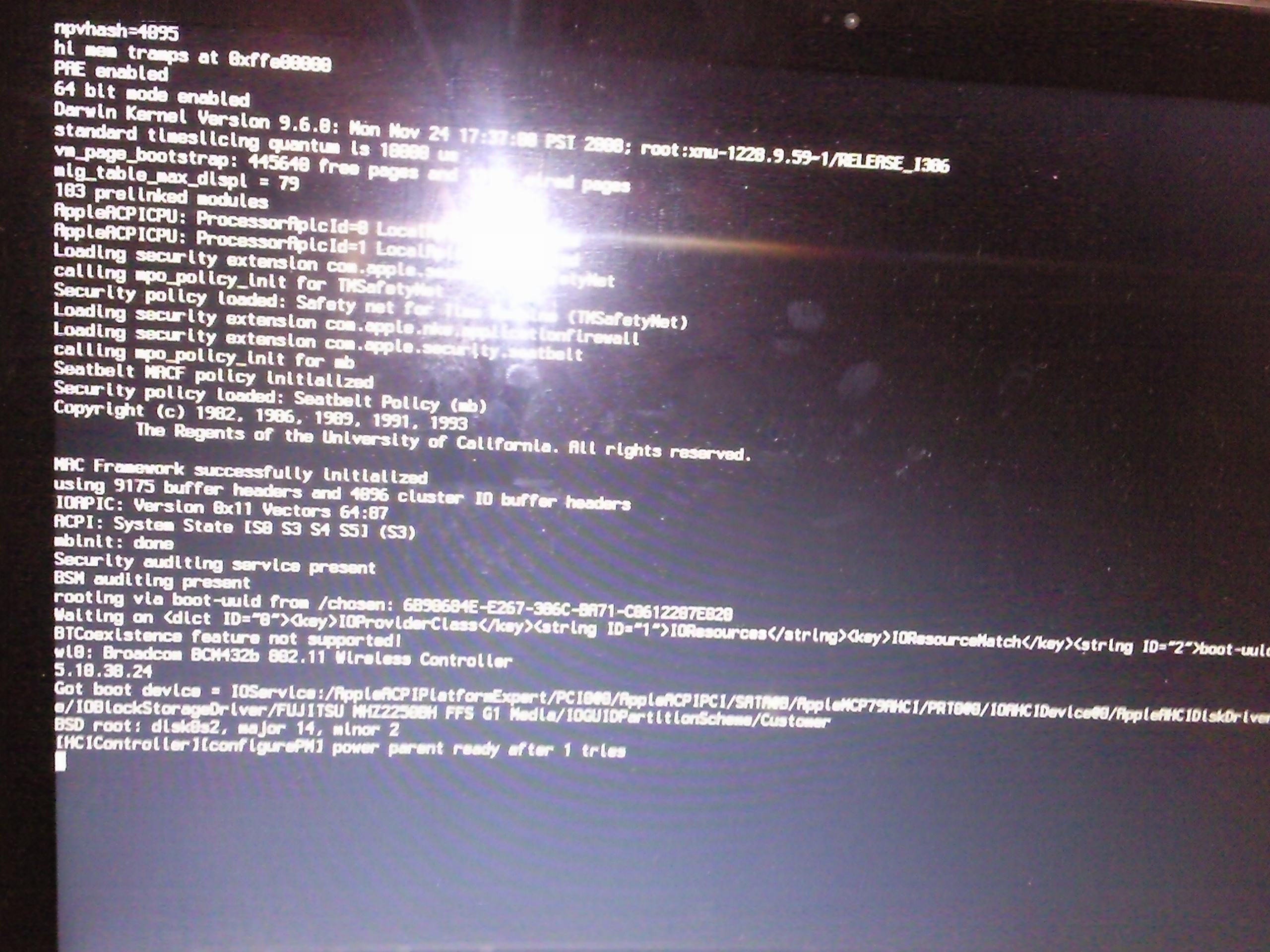

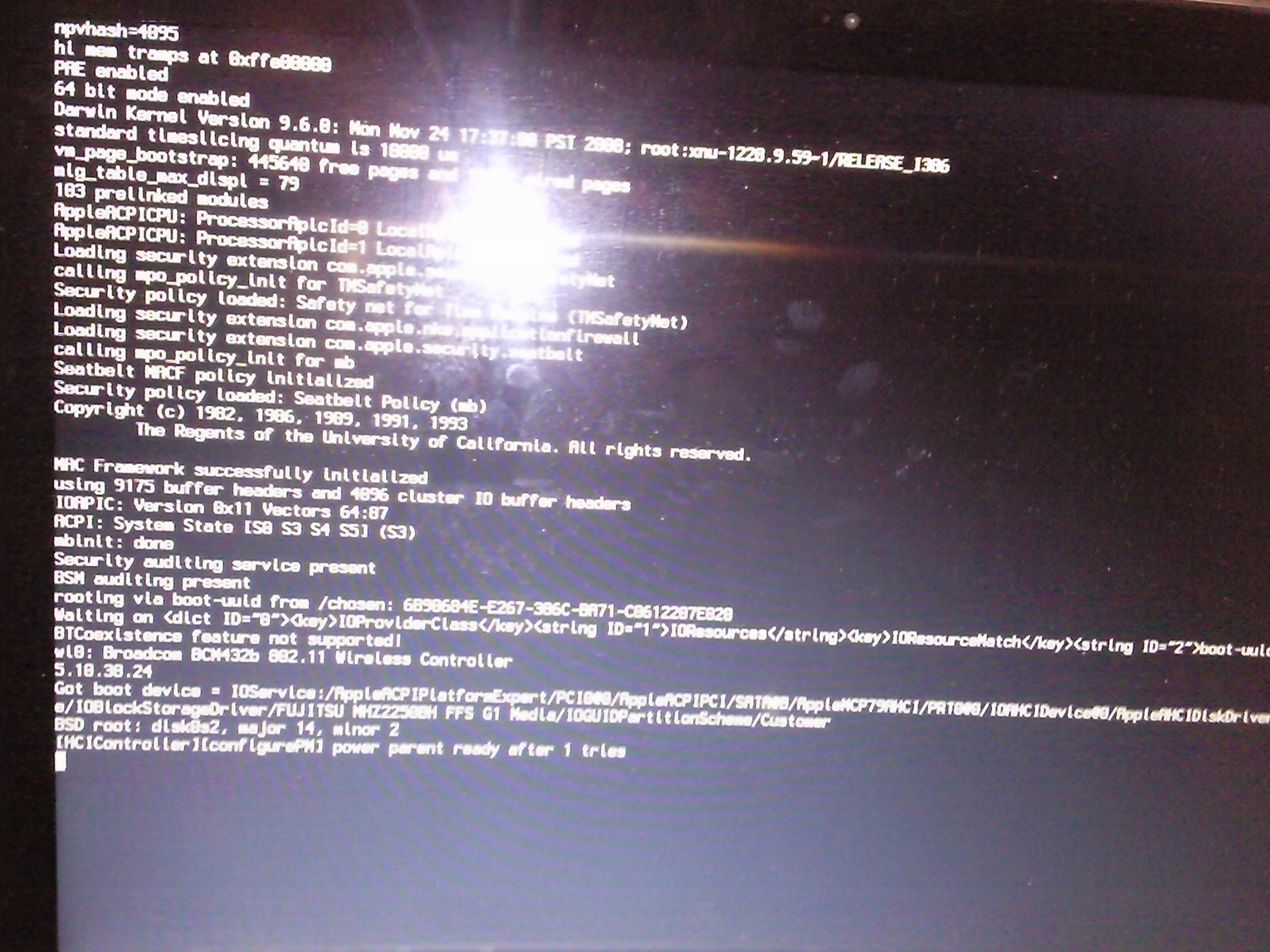

I'm kind of new to Macs and all. I recently re-installed Leopard 10.5.5 and made the upgrade to 10.5.6 Everything works perfectly fine. The only thing is that when sarting up and also when shutting down, I get instead of the Apple logo and the little spinning wheel thingy, a black startup screen that looks like DOS.

You can turn this off - it is turned on to help diagnose any hardware problems.
I've had a look around and I really can't find anything that details on it - there was a post here once upon a time that detailed it but I can't find it.
Duff-Man says....sounds like you are starting up in "verbose" mode. For those not used to fooling around with the terminal you should be able to toggle this on/off with any one of several utilities - many of them free too....try Onyx..it's handy to have around anyway....oh yeah!

Thanks for all your help but unfortunately none of the options did the trick. 😕 I downloaded Onyx but cannot find where to be able to disable/enable this option. Any more suggestions?
Thanks!!

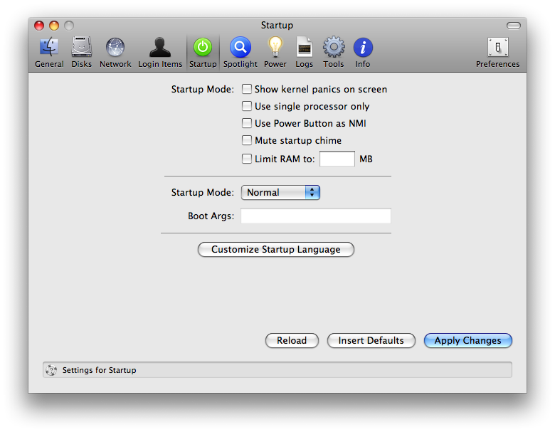

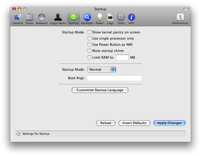

I also downloaded MacPilot which has a startup customization screen but I don't know if the answer is in there. Attached a print screen of the tab.
