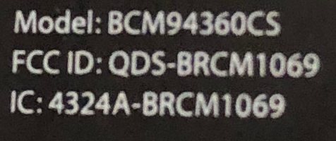

Consider buying one of these with adapter for miniPCI.
That's the one I have in my iMac 2007 and I have continuity working.
I bought it in ebay for about $40,00 US
