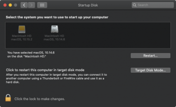

I installed OpenCore, everything went really well. There is one small issue I have, I cannot go back to Mojave Startup Disk, it always boots on Catalina. I select the Mojave disk and shutdown the Mac, then I unplug it for 30sec and plug it back. Back to Catalina, instead of Mojave.
I apologize in advance if I ask the question here, but it might be easier to track the issues.
Ping @cdf @tsialex
Booting other macOS disks through OpenCore (RequestBootVarRouting = true) can be tricky on the Mac Pro, but selecting the disk, shutting down, and doing an SMC reset (unplug, wait 15 seconds, plug back, wait 5 seconds, and then power on) has always worked in my case, and often it works without an SMC reset.
To begin troubleshooting, this is what I would do: Reset the NVRAM, so that your machine boots into Mojave (that system being on a SATA disk). At this point, repeat step 5 in the guide to confirm that you can boot into Mojave through OpenCore (make sure to select the disk in recovery, because of your Catalina disk). Then boot into Catalina and try going back to Mojave.
Of course, if you cannot get it to work, you can always just boot natively (see step 8 in the guide), and use OpenCore only for updates. When booted natively, you should have no problem booting into Mojave.

For changing the boot order first you have to bless the opencore.efi (SIP disabled) and then select the startup disk normally.

Selecting the disk, shutting down, and doing an SMC reset (unplug, wait 15 seconds, plug back, wait 5 seconds, and then power on) has always worked in my case, and often it works without an SMC reset.
That is what I did, it would not reboot into Mojave. I tried all possible and impossible ways to resurrect it, I ended-up removing the Catalina PCIE 3.0 ssd, deleted its contents and redid the install. Now everything is working properly. 🙂

I've opted for Catalina on a PCIe drive and Mojave on a standard SATA SSD. With the SSD in Bay 1, the machine boots automatically into Mojave after resetting the NVRAM.

My experience: I’m running MacOS Catalina 10.15.2 now on a PCIe SSD drive (512Gb EVO Samsung 970) and have kept the Mojave (latest version) on a SATA SSD drive (Bay 1). Both work just fine and I’m able to switch between the two without any problems.

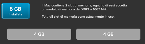

hi guys
tried to upgrade to Catalina on my macbook 5.1 but it doesn't work,it s very slow and you can do pretty much anything.
any tips?
this I my machine
thanks in advice
