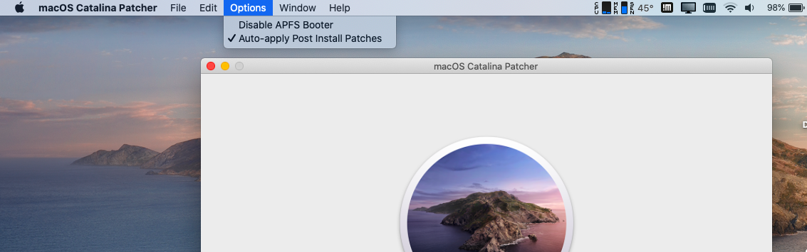

When creating your usb patcher you can deselect the option to apply the patches automatically and/or APFS patch.It's under the options menu but I'm not sure, just find it and deselect that option. After installing you need to boot with the usb patcher and apply all the relevant patches for your model except the video one.

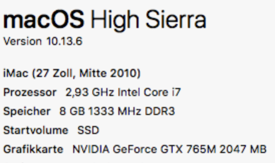

Hi Luis,
Thank you for your hints!
I deselected the auto-apply option and re-created a new usb image for Catalina setup. In order to do this I needed to switch graphics cards and afterwards I was able to re-install High Sierra (with Nvidia GPU - see screenshot below) and setup two APFS volumes: one for High Sierra and one for Catalina.
As it is not possible to set the start volume to the Catalina installer or choose the boot device via the option key: Do I need to switch graphic cards again to reinstall Catalina? Or is there another trick to boot from my usb stick?
Best regards,
Heiko

Yes, that's the best solution since you have disabled the auto patcher. Switch graphic card and apply the relevant patches for your model except the video ones
