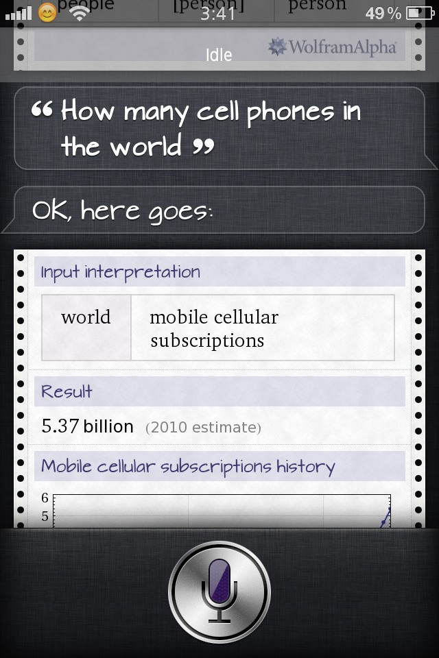

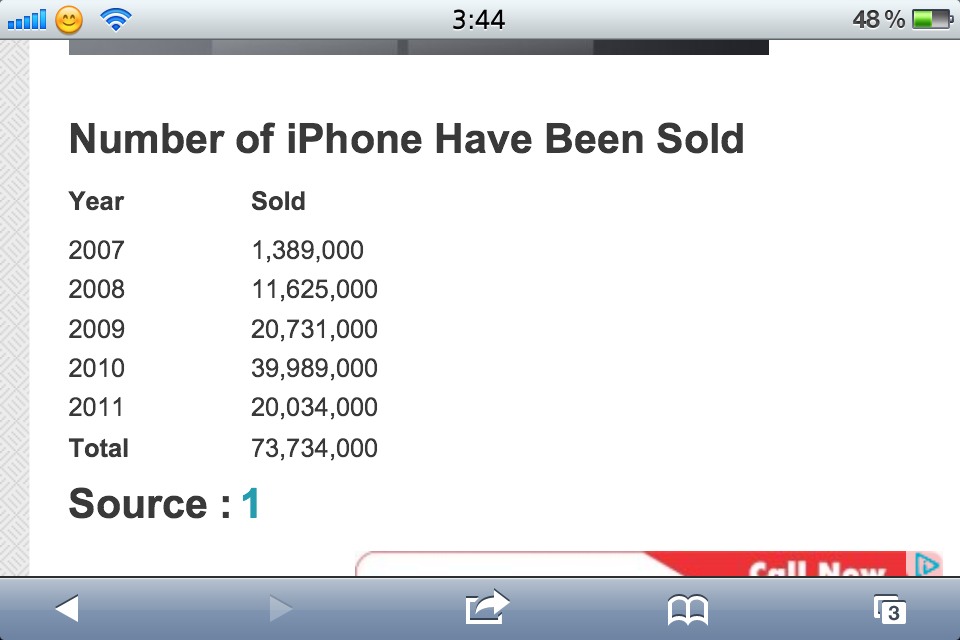

btw check out the stats on the mobile subscribers in the world and the number of iPhones available 🙂. there's always a market until it gets saturated, but it's never as big as you imagine it.
