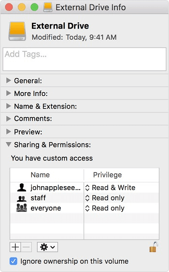

For the drive which still mounts open the "Get Info" in Finder, expand the "Sharing & Permissions" section, then click the lock to authenticate. Check "Ignore ownership on this volume".
Read-Only External Drive on Mac - Solution 2

This option is already checked.

Looked at the one it worked on, and I had already checked the "ignore ownership" on the drive, yet it seems to still be owned by the one Mac.
