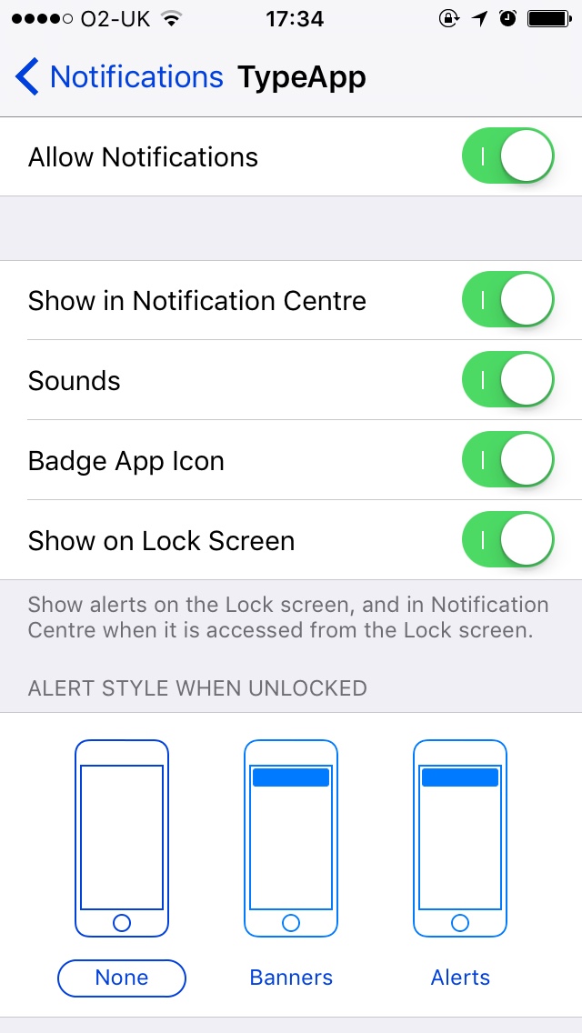

Yes exactly that. Sorry was rushing my reply before and lacked quality information. Yes I had the chime to indicate a notification but not the actual visible notification upon the lock screen itself.

Hello, for example I had type app set to not show on lock screen so the last button was set to off. This meant I got a ping. Then an immediate ping and banner the minute I unlocked my phone. In fact I got one for every item that had come through whilst locked!

Try turning "alert style" to "none". Leave "show in notification center" and "lock screen" in "on" setting.
