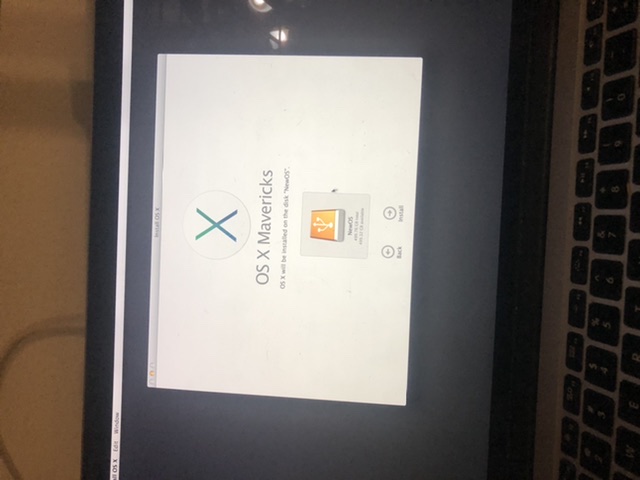

SUCCESS!!! Ish. Lol. Followed these steps (thank you for such detail!) and now have Mavericks running on the external hard drive. Now what??
Side note: when asking where I wanted to install it, the external HD was the only option. Screenshot attached.

OK, so you can boot and run your Mac with Mavericks from the external drive?
That's a start.
Now, IMPORTANT QUESTION:
Do you want to GET RID of Catalina?
That can be done, and you can get Mavericks running on the internal drive, if you want.
Once you have done this, you can then upgrade Mavericks to Mojave.
I'm not sure if this can be done "in one step", or if an "incremental upgrade" will be required.

Could've saved myself a week of starting a process before work, doing a couple of steps in the evening, then setting something up to run overnight. Plus I spent a LOT of time moving files around on hard drives to get one I could safely erase. But, bottom line is I'm back to Sierra, with everything how it should be. Upgrading to Mojave in the near future AFTER doing a proper backup. Thanks for all of your help!
I wiped the Catalina drive, then tried to install Mojave through Internet Recovery. That failed with different error codes (3101, 1008 etc.), both wired and wifi. Then installed Mojave from a USB Installer I had prepared many moons ago.
However, it appears the Catalina downgrade is not very graceful because after spending almost a day on the above activities, I found that while the OS itself worked fine and my apps worked fine, somehow the recovery partition was borked and my Mac wouldn't boot into recovery mode no matter what. So ok, I thought I can always run recovery from usb, lemme make a new USB Installer with 10.14.6. I made 3 sticks, 2 using createinstallmedia and one with Disk Creator, strangely none of them worked.
At this point, I was ready to give up and tried Internet Recovery again. It worked now and am back to Catalina which is OK. No, I did not have a time machine backup because I keep my data in the cloud.
