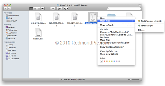

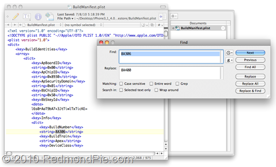

Step 3: Open the buildmanifest.plist with the Notepad if you are on Windows, or TextWrangler if you are on Mac.
Search and replace all – 8A306 with 8A400. Save. Repeat the same with the file restore.plist.
