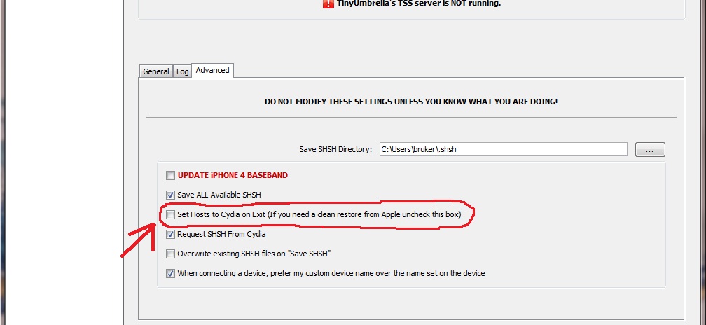

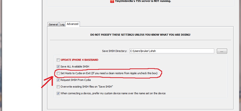

See this picture, this is from TU, if you have this checked, please uncheck it, and try the sequence again. Pretty sure you wont get error this time.
Really do appreciate the responses. That box is unchecked.

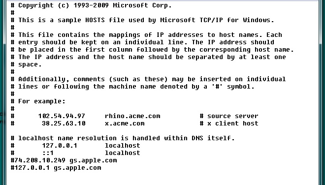

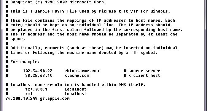

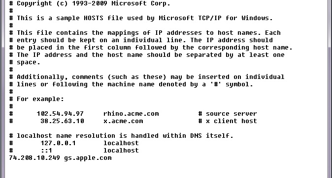

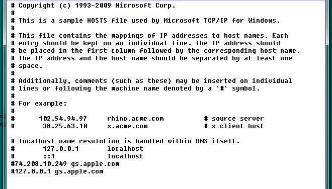

What about your host file?
Here is two examples:
Check if your host file is something like this i posted. the first is for itunes use with orginal firmware from itunes,
second one is when you use TU and cydia as server for update to custom firmware with itunes.
