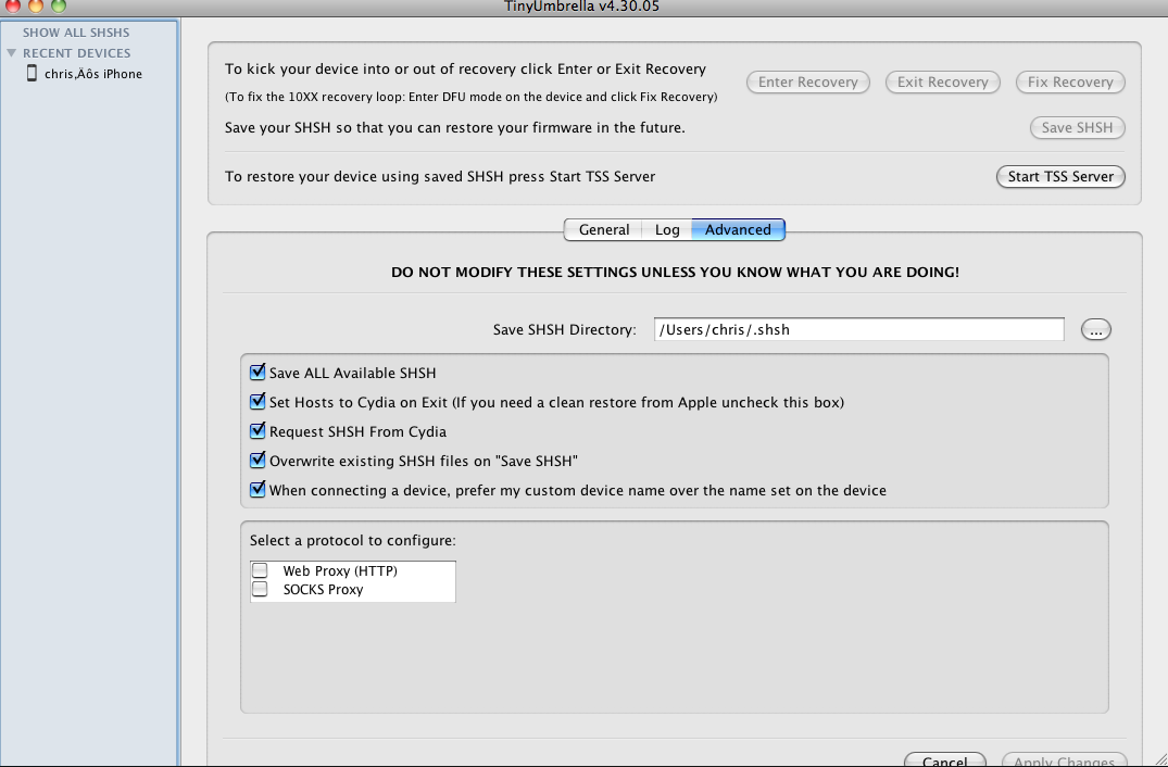

Using TinyUmbrella go to the advance tab in the middle of the screen. Check the request SHSH from Cydia. Make sure blobs are saved in TinyUmbrella before you start your restore.
