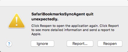

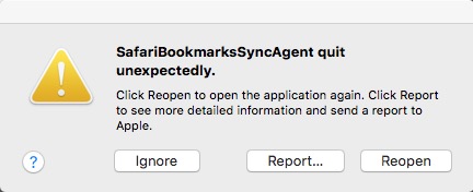

Unfortunately this has started to come up every minute. Any thoughts on what's causing that? Snap 2018-09-19 at 4.52.38 PM.jpg
Unfortunately this has started to come up every minute. Any thoughts on what's causing that?View attachment 784092
Honestly, no. What macOS version are you running? You might try unchecking Safari in the system’s iCloud prefs. Then logging out of iCloud, rebooting your Mac and log into iCloud and recheck Safari.
If that doesn’t work try reinstalling Safari 12 again and see if that fixes the issue. And if you’re brave, & or have the time, try reinstalling Safari 11 again. If the problem comes back, it could be one of your extensions. Try turning them off all at once, quit Safari & see if the sync pop up comes back. Keep turning on one extension at a time quit & relaunch Safari. It’s the way to see if it’s an extension and Safari 11.
If none of that works, reinstall 12 & call it a day.
Good luck!
Thanks for your reply! I actually tried a reinstall but that didn't help. I ended up disabling the agent and now I don't get a application crashed notifications every five seconds.
I did that by:
cd /System/Library/CoreServices/SafariSupport.bundle/Contents/MacOS
sudo mv SafariBookmarksSyncAgent SafariBookmarksSyncAgent.disabled​
(with SIP off)
Obviously this will kill the bookmarks sync but you can't have everything... YMMV.
