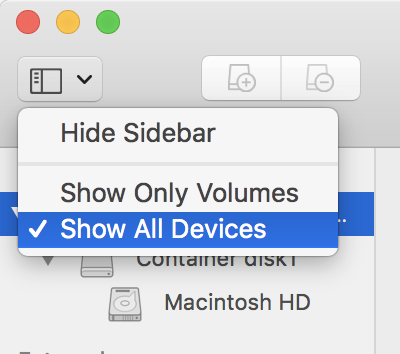

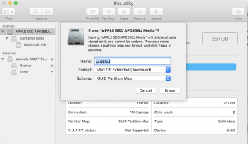

Boot from your SD drive then start Disk Util and enable show all devices like in my screenshot. Then select the drive hardware itself at the very top of the left column like in my second screenshot and erase back to HFS+. By selecting the drive up top you are erasing the entire disk, including any APFS containers.
Where you would have a problem is if you just selected Macintosh HD to erase, as that would not get rid of all the other partitions/containers.
Screen Shot 2018-02-12 at 5.52.31 AM.png Screen Shot 2018-02-12 at 5.52.19 AM.png
