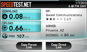

My dad came home with a new iMac a few weeks ago and its been running fine until a few days ago. It takes forever for anything to download. I tried downloading FireFox and it would take me hours to do so and I know it should only take a few seconds.
I did a test @ speedtest.net and well i don't think it's looking too good.
I'm not tech or computer savvy so I don't really know what to do about this.

Get in touch with your internet service provider. Do you have dial-up? Doesn't look like you have a broadband connection. Either that or your settings on your modem are set wrong.

Wireless or wired connection? What is the advertised speed of your connection?

7 Mbps sounds like DSL not dial up, comes through the phone line but it's much faster than dial-up and always on. With the Ethernet cable plugged in you should be going wired which eliminates similar issues I've seen with bad, or highly interfered with wireless channels at home.
You may want to double check your network settings since it is poosible to change the preference order so that wireless would be picked over the wired Ethernet port. You can just turn off the wireless connection on the iMac and be sure that it's only connected via the wired port. If the problem persists call your ISP.

since the router has a yellow light, disconnect it and completely bypass it. Connect your computer directly to your modem, power off both, leave for 20 mins and turn on. see what happens
