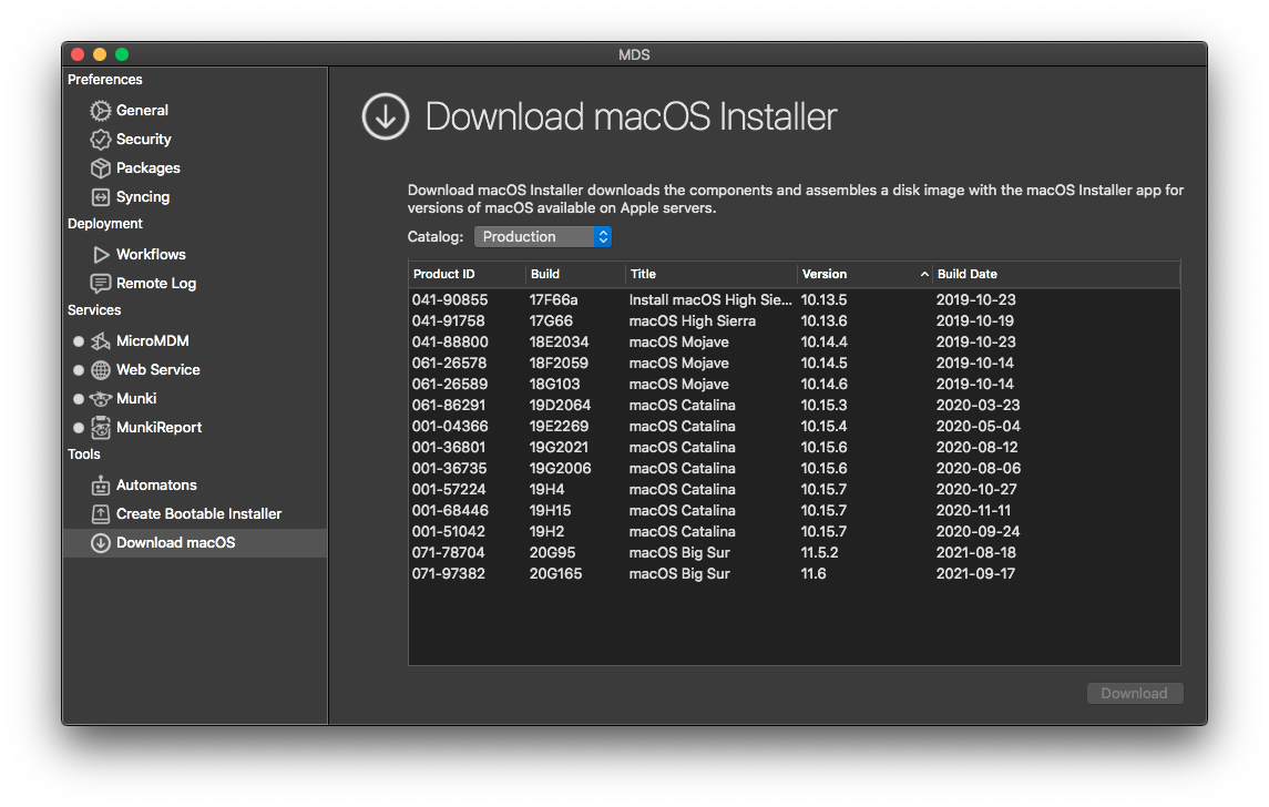

To answer the original request…you can get the macOS 10.14.4 installer via the MDS app.
This shows what is currently available:

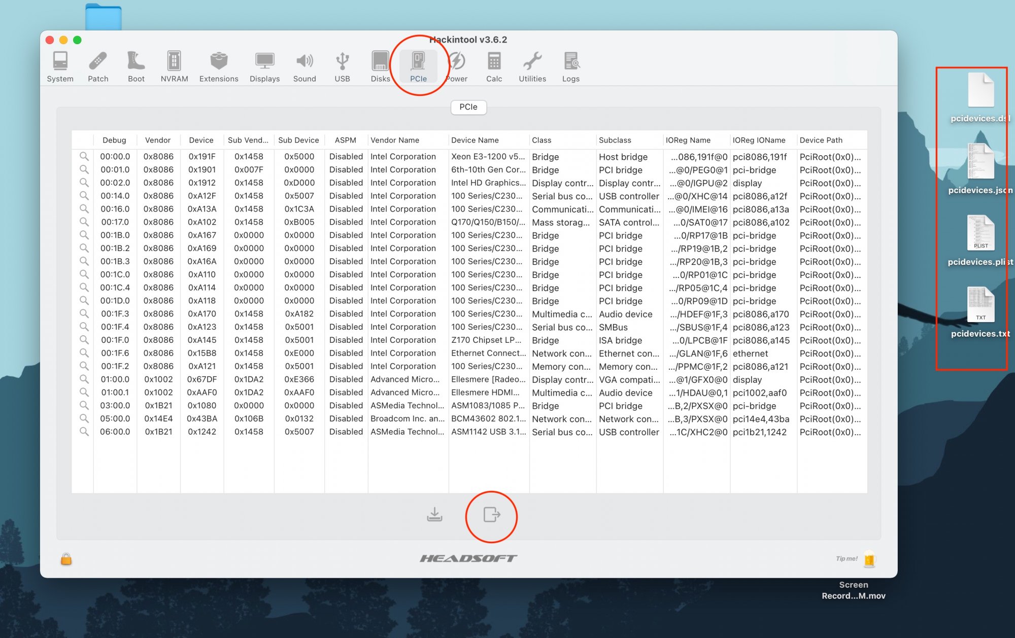

What steps have you done on the mac pro so far?
Also, you're not flashing anything with respect to the graphics card. That's too risky. For the fan issues, all we're doing is injecting some powerplay tables on the fly. There are no changes being made to the graphics card's firmware (aka the vbios)
Anyways since i dont have a mac pro, im going to need some more information (specifically your PCie location of your GPU). Can you download hackintool and give me the information plus a .zip of your opencore EFI (once you manage to get it booting macOS through it)
See attached. I need those 4 files that get created

The first attachment is from the Hackingtool
It wouldnt let me attach the EFI zip as was too big ??? (16.3MB)
But im not sure of Ive gone far enough in the process to be sending your the right EFI ?

Ok perfect. I found out the path to your GPU.
As for opencore, the one hosted here is probably the easiest to work with as I reckon the folks on that thread has already done most of the work to get it to run properly on the mac pro
Also, you can use hackintool to mount your EFI partition - it might be easier than messing around with terminal -especially if you have multiple disks
