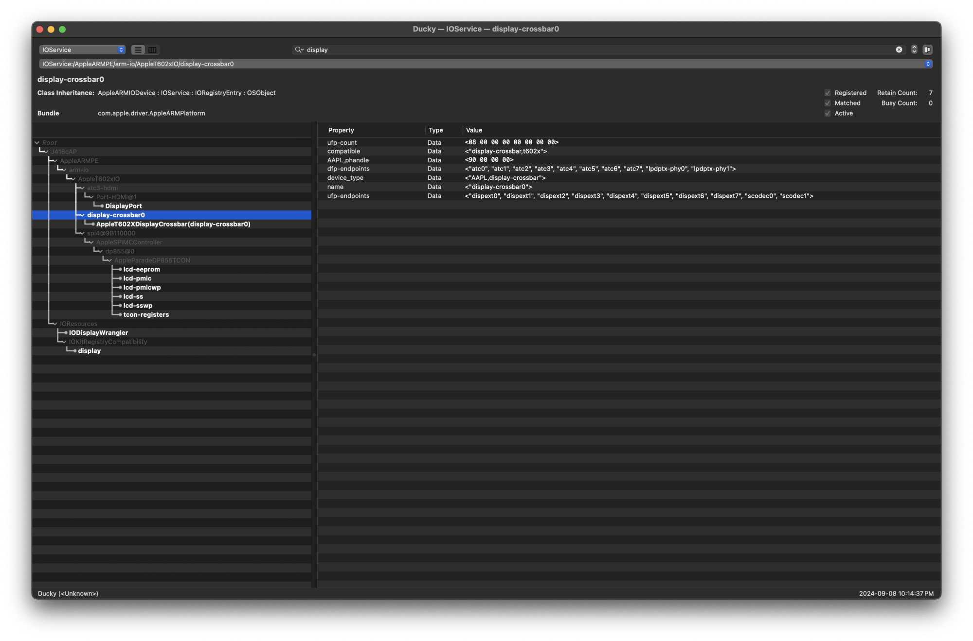

I found some interesting info in the IO Registry. The first screen shot shows the display crossbar which references both ufp and dfp. So, that suggests that there are both source and sink capabilities.

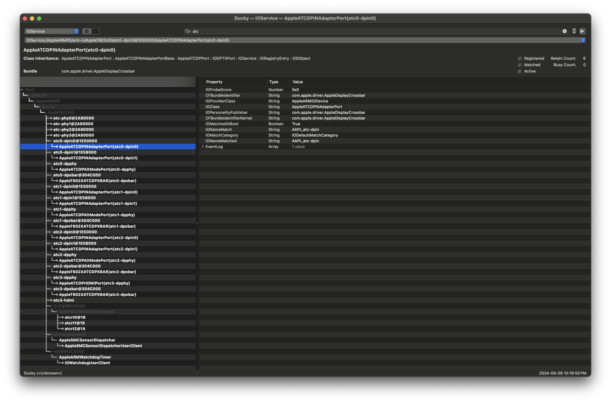

The second screenshot shows the info for the dfp's. Seems backward to me but we can clearly see there are three ports with DP Alt mode corresponding to the three USB C ports on the MBP. There is a fourth DisplayPort interface connected to the HDMI port. Unfortunately, when open the screen using Quicktime and close Quicktime, there does not appear to be any difference.

I agree with @galad . I believe the thing you're looking at in IORegistryExplorer is evidence of the internal crossbar switch which connects SoC-internal DP sources to the "atc" (Apple Type C) ports. Each type-C port appears to have two inputs that are fed by the crossbar.
