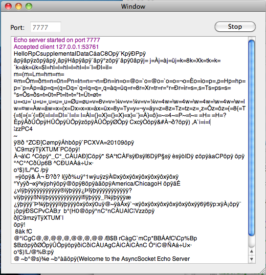

Now it does post my message up when received but it also adds a bit extra. (Picture of it below)
Any ideas of why it'd do such a thing?

I would suspect that a buffer is assigned for reading that is bigger than the incoming data. Terminate your message with the correct string terminator (\0 : this is basic C!) and it should work.
To pinpoint the issue. This:
Code:
uint8_t buffer[11] = "I send this";
is not a valid string (in C which is the level we are at now). This is:
Code:
uint8_t buffer[12] = "I send this\0";
I would suggest you brush up on your C if you are going to use this level of API.
