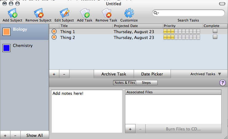

Hey guys, I've been wrestling with this problem for a while now, and I can't seem to come up with a solution. I've got a subclassed TableView that has a special column for drawing circles, based on the color assigned to the "parent data" of the table. (See Pic 1 for details.)
The problem is, when I switch over to a different parent, like to the blue subject, any tasks I add will have the same peach color, *until* I exceed the number of earlier-created subjects. Confusing I know, but here's an example:
I've got the situation seen below. I switch over to the blue subject, and create a task. It's peach. Create a second, it's still peach. Create a third, however, and they all turn blue. When I go back to the peach subject after creating that third blue task, The original two peach-colored "Thing 1" and "Thing 2" objects have turned blue as well!
Here's what I'm using, in a subclassed NSTextFieldCell:
Code:
NSColor *taskParentColor = [NSUnarchiver unarchiveObjectWithData:[[currentObject valueForKey:@"parentSubject"] valueForKey:@"color"]];
[taskParentColor set];
NSBezierPath* thePath3 = [NSBezierPath bezierPath];
NSRect bounds3 = NSMakeRect(cellFrame.origin.x + (cellFrame.size.width / 2) - 5, cellFrame.origin.y + 3, 10, 10);
[thePath3 appendBezierPathWithOvalInRect:bounds3];
[thePath3 fill];
I'm assuming there's something wrong with the way I'm drawing the circle, but I'm not that familiar with custom graphics. Here's to hoping you guys know a bit more than me! 🙂 As always, thanks so much for your help!

currentObject is the object in the TaskController (NSArrayController for the tableview) at the current index (row) the table is displaying.
Edit: Yea, I see how that example works, thanks a lot for it. 🙂 I think my way kind of works the same. Instead of actually binding to the color, it's just getting the color when it's asked to draw itself. So currentObject has a parent, the "Subject". The subject has a key "color", so when a task is being drawn, it's getting the archived color of its parent, and drawing that in the first column. I know it's at least *getting* the colors, since they show up, they just update oddly.

Somehow, (it was a while back, I don't remember) I have an observer set up for when the subject changes, and in that code I'm calling [taskTableView reloadData] on the table.
And I'm using a Core Data model, so to store it as "Binary" (since there's no "Color" option) I have to archive the NSColor object.
I also just noticed, after messing with it for a bit, that if you click on a task then off it, somewhere randomly on the table, (to deselect the task) a few times, it will switch back and forth between the right and wrong colors. 😕
This is just getting weirder and weirder!
Edit: So what seems to be happening, after a few more NSLog's, is the currently-drawn item isn't always reporting the correct parent subject. How exactly is drawing updated when using Core Bindings with a Core Data model for a TableView?
