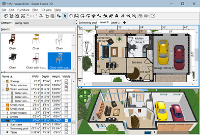

I've done several plans on Sweet Home 3D which is probably similar to the ones mentioned above. It does a pretty good job and it's donation ware so it's up to you to pay. It comes with a lot of objects and there are loads more you can download. There's a lot of help too.
Reactions: carlsson
