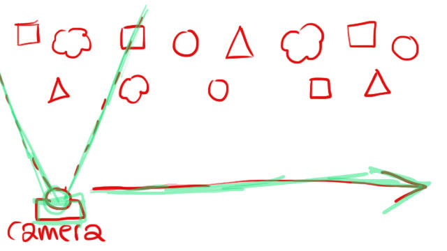

so i've had the idea to create an incredibly long panorama, as an intermediate for an incredibly long traced picture. 😀
does anyone know of a tool that can generate a "panorama" of drive-by footage?
by drive by, i mean something like this:
now, i know that due to things being a different distances from the camera and due to the camera moving there will be perspective errors, different povs and etc.
but it doesn't need to be perfect, as it will only serve an intermediate purpose: i can live with blending and alignment errors.
in theory it would be good enough if i manually aligned and blended the images in photoshop, but 650 frames are a lot.
i wouldn't mind having to set a few alignment points for every frame manually, as this would still be a lot less work than the photoshop route.

the plan is to use a compact camera and use it to record video out of a train window. i made a test recording today and came home with ~1.5km "panorama" footage.
because it was a sunny day i got reasonably high shutter speed and so 95% of all frames are blur-free.
the original material has 3900 frames, but i can reduce that to ~650 frames and still have 1/5 to 1/3 overlap between frames. the overlap varies because sometimes things are further/closer away and the train wasn't moving at a constant speed.
according to my calculations the finished "panorama" should be between 80000 and 100000 pixels wide, but only <1000 high.
any ideas and help are appreciated 🙂

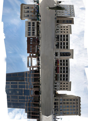

I did a similar panorama for an imaging class last year. Had it not been for a grade I would have given up. It's next to impossible. Here's the final image I ended up with:
That was composed from 650 shots taken at roughly 3 feet intervals. I spent a total of about 70 - 80 hours stitching them using photomerge in photoshop. It's a slow process and will tax even the fastest computer.
The smaller the interval between shots the easier it will be to stitch. What ends up happening is that you only really want to use the very vertical center of the frame. As you move out from the center horizontally the perspective in the picture becomes more and more different from the previous and next pictures. That effect is exaggerated the closer you are to the subject.
My suggestion would be to try photomerge with 20 - 30 pictures and see what it spits out. If it works continue doing it in 20 - 30 picture increments with 5 - 10 pictures of overlap. Once you have all those stitch the stitched pictures together. There's going to be a couple areas that it simply refuses to stitch and you'll have to mess with manually. If you try to do it all at once those areas will ruin the rest, hence the small chunks. Also, be prepared to spend a lot of time sitting and waiting while your computer seemingly does nothing. It seems as if photoshop isn't particularly well optimized for this type of task... much of the time spent the CPU usage is low and it isn't writing to the disks. I'm not sure what it's doing, but unless you run out of scratch space it will finish eventually.
There's other more advanced stitching software then photoshop that may give you better results, much of it free, but most of the programs I used required fairly advanced math that I simply wasn't up for learning.
Hope that helps, and best of luck.

I did a similar panorama ... I ended up with: neat thingie
... from 650 shots ... at ... 3 feet intervals. I spent ... about 70 - 80 hours stitching ... will tax even the fastest computer.
that is neat, and a lot of work 🙂
tax the computer? good thing i only have a 1st gen macbook with 2gb of ram. 😉
