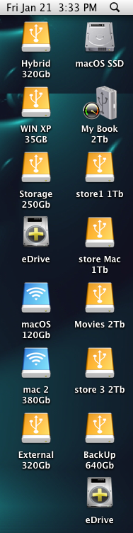

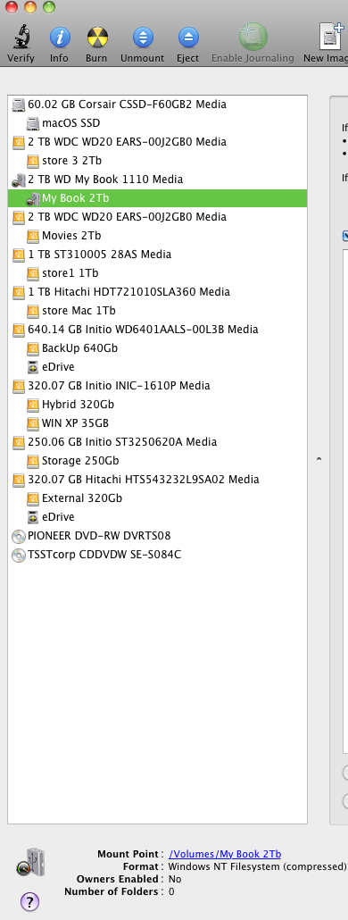

I'll show you how many hard drives I have plugged in my Mini. Most are PC OS based (I have 6 Macs + 4 PCs). As you can see my 'My Book' (back-up + torrent downloading) is NTFS (windows) & is 24hrs being used on my Mac:
(And all these HDs are hooked-up thru USB)
