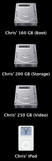

For reference here is my set-up (it works very nicely):
attachment.php
EDIT: Forgot to say that all three internal drives are separate with no partitions. i hooked up the 3rd drive by splitting the ata cable going to the optical drive and resting the drive above the optical drive.
