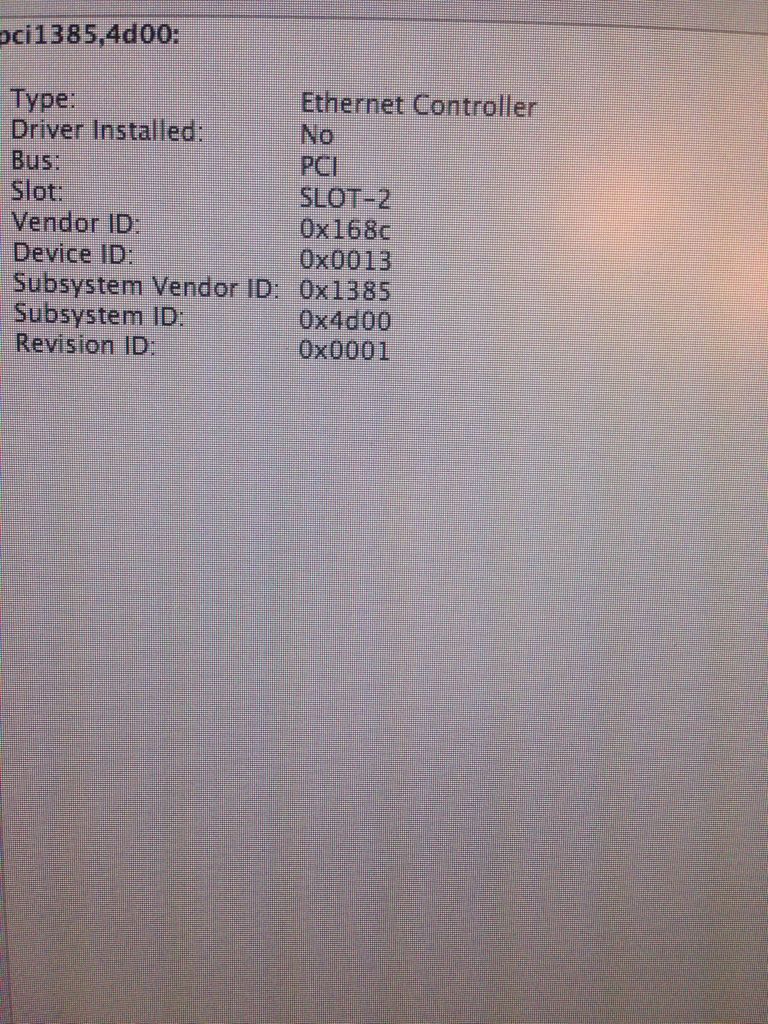

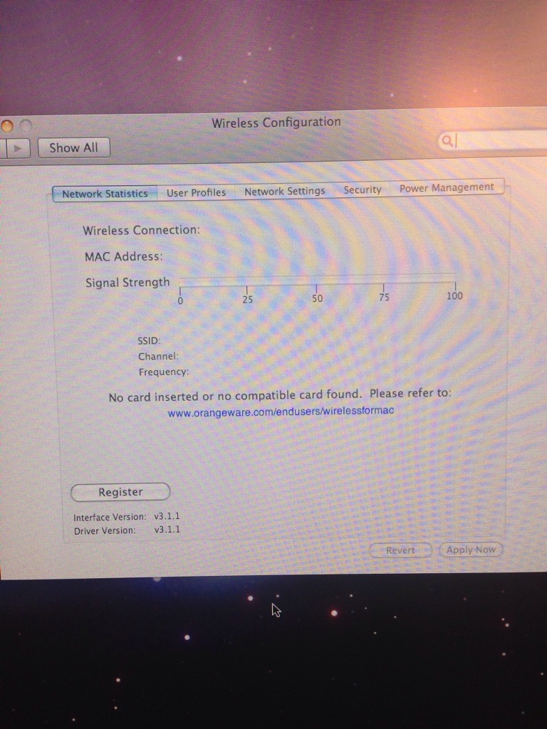

Scavenged one of these from an old pc for my MDD but it isnt recognized by my comp. I tried version 3.3.3 of Orangeware but it can't recognize it either. Is this futile or can anyone help with this.

What version of the card is it? These cards had a couple of chips across the same series.
Does this help? This is the card
Oh and this

I did though see something about a orangeware wireless driver 3.1.1 making this card work for a beige g3.
Just found the file, didn't find the card
What exactly do you mean? Do you mean you could not find the device identifier in it? I would try rolling back the IOPCIFamily.kext to the one from 10.4.5 first as that seemed to have more Atheros networking support.
Bingo! I installed it on my hd with Tiger and it works. Is there any way it can get it to work with Leopard?

In the end it seems only WEP is recognized under Tiger, I do appreciate the help but probably will end up sticking with sharing the connection from my macbook pro instead.
It's running 10.4.11 but the program to use the pci card only gives me open or wep as options
