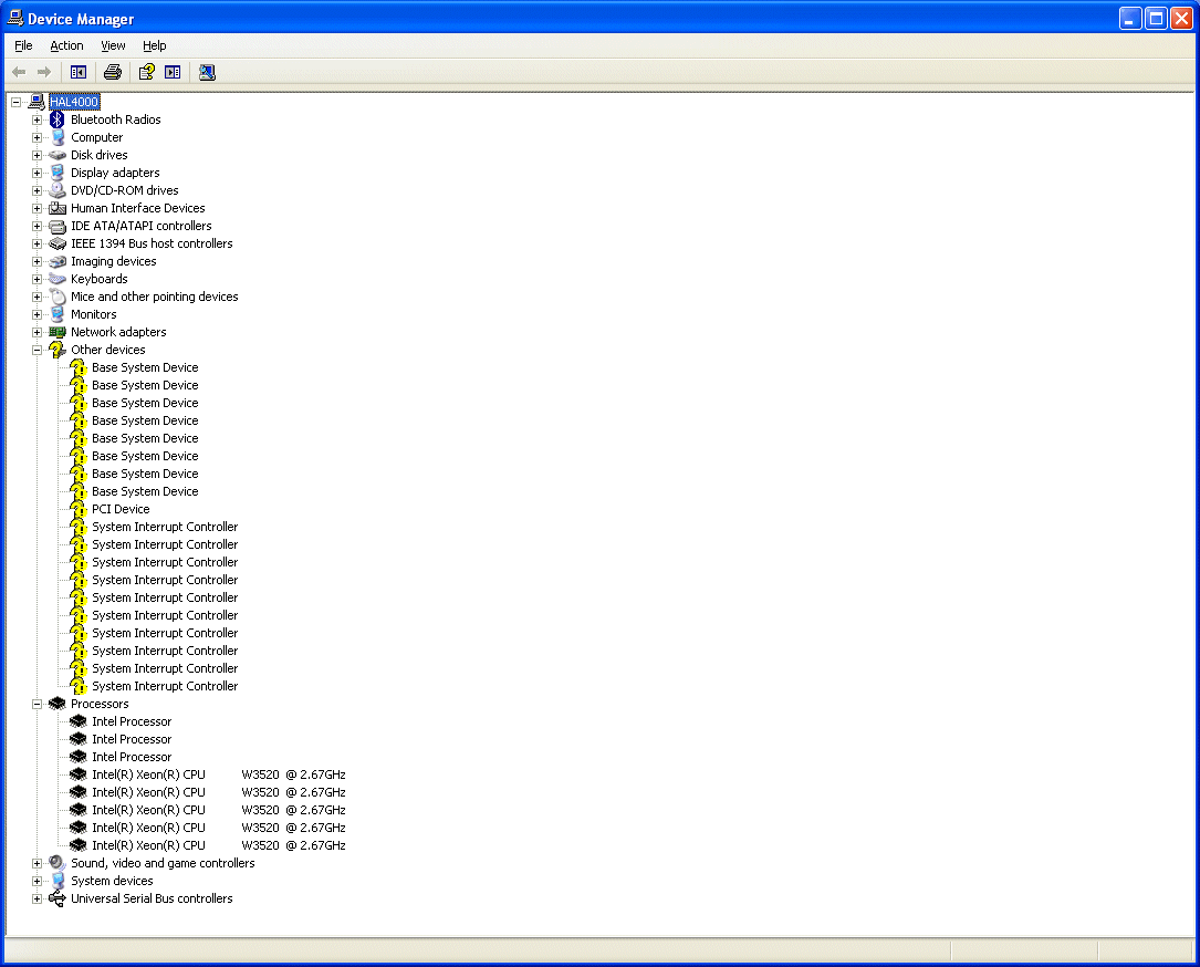

I'm beginning to wonder whether I have a dodgy boot-camp installation.
Just had a look at the device manager and there seem to be a lot of devices that lack drivers or are not working. Most of them are called 'Base System Device' or 'System Interrupt Controller'.
See attached screenshot for details.

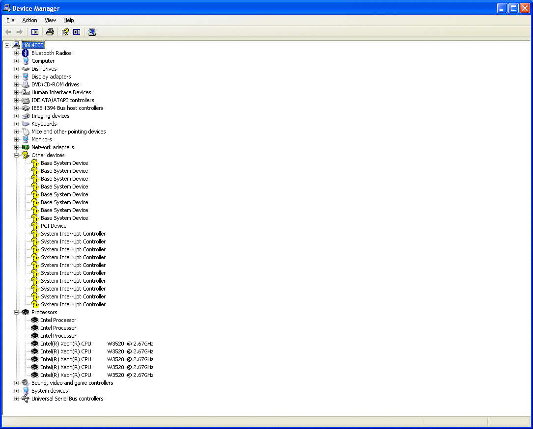

I remember that happening when I reinstalled Xp on my cousins dell, You have to install all the drivers, those seem to be processor related or chipset related.
