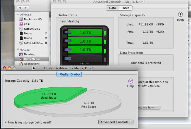

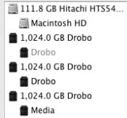

The Dashboard part that shows the pie chart shows 2 drives. When I click advanced options it shows 3 1TB drives. To answer your 2nd question directly, I will have to wait until I get home.
All lights are green which makes me think I'm making a big deal out of nothing.

This is what I mean
From your pics it looks like Drobo dashboard is working fine - it shows three 1TB drives installed and the pie chart shows how much of the total available space is used (across all partitions).
Your Mac doesn't see the three disks in your Drobo as separate disks - it see Drobo as one big disk of a size chosen when you first format the Drobo. Like any other single disk you can use disk utility to divide this up into partitions that appear as separate volumes. This is what I can see in your screen shots.
The Finder sidebar is showing two volumes mounted which are partitions on the Drobo one is called "Drobo" and the other "Media" - disk utility is also showing both of these and an extra unmounted (greyed out) partition - also called "Drobo".
There are several reasons why this third partition may not be mounted. It may be unformatted space, corrupt etc. If you highlight it in disk utility and press the "i" button it should give the detail of the size and format etc.
