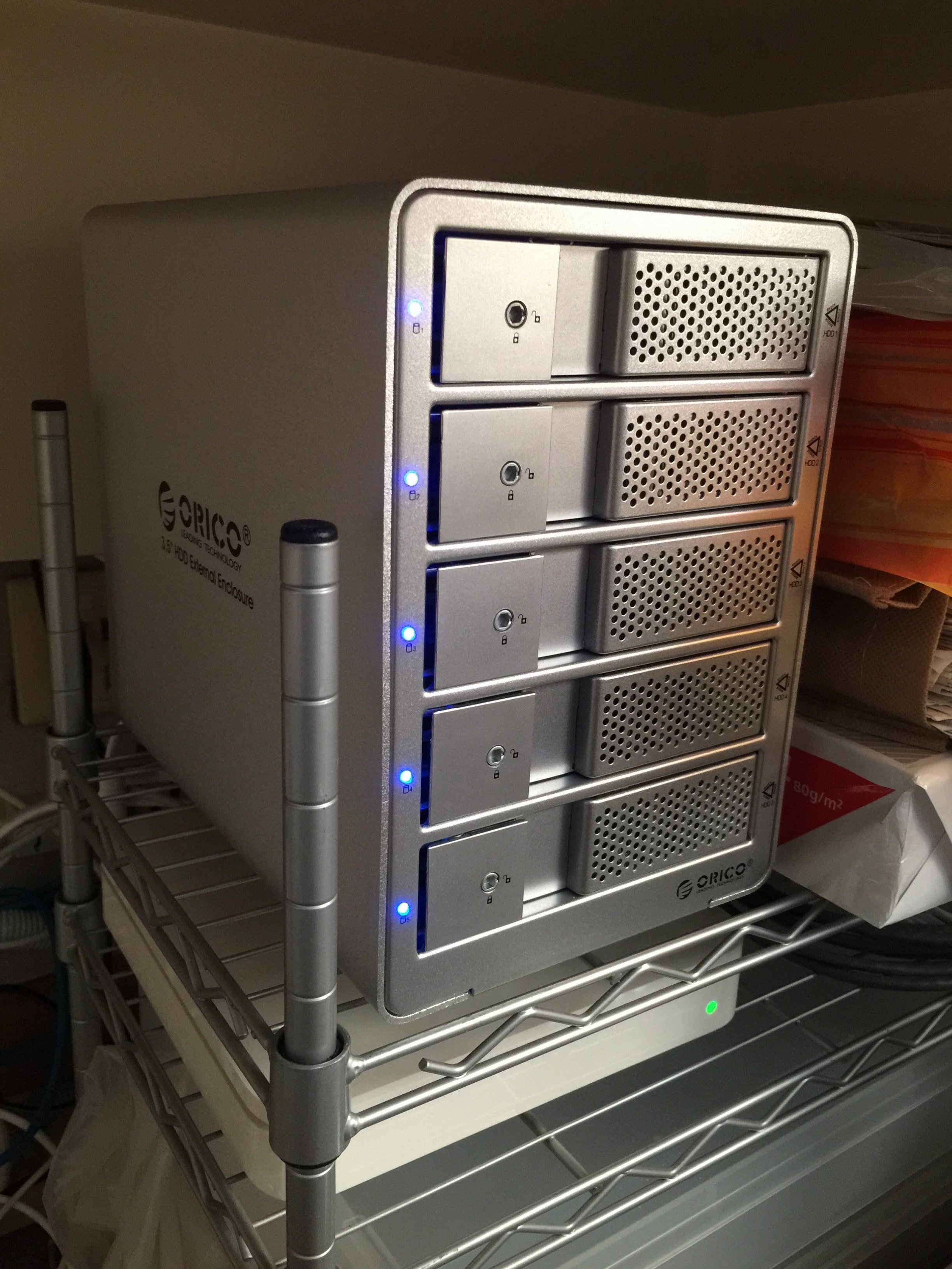

I use the Orico USB 3 enclosure. Which can support 5x6T HDD (larger HDD may work, but never try). Which is a simple, fast, large storage option.

I dropped 4 x 3TB HGST Deskstar NAS into one, but they can take 6TB. With it 2/3 full, I get 330MB/sec from it.
The one I am using now cost less than $150. If you put 5x6T in RAID 0 (this enclosure also support Hardware RAID 0,1,5,etc), it's not hard to get something more than 400MB/s.

Well, I use RAID5 with my enclosure, but if I was crazy enough to run it RAID0, it would be more like 600 MB/sec.

In fact, some HDD in this enclosure is for backing up normal files of some internal HDD. And some others are in RAID 0 for normal data storage. Besides that, I have 2 Time Capsules to double backup the important data. Also, one of the internal HDD is the clone is my SSD, which serve me as a backup boot drive.
When I use this enclosure, I did think about to use RAID 5. However, that means I will need another large storage for the backup (since there may be no way to recover the files if the RAID controller itself become faulty, so RAID 5 is not safe enough for me). I end up only use software RAID 0, manually setup few different logical volume, and use CCC to automatically clone the data between drives as normal backup. And my setup do avoid cloning between drives inside the enclosure, as you said, it will slower. And I have 4 internal HDD bay anyway. So I can easily make it only clone form internal HDD to enclosure, or enclosure to internal HDD.
By the way, what do you think about RAID 5? Do you think it's really safe enough? I know it has some sort of protection from HDD failure. However, as I said, there may be no protection from RAID controller failure. If I buy another enclosure (same model number), and then put the HDDs back it, will I able to recover the data? This is my biggest concern and why I didn't use RAID 5. I would like to learn from your experience and try to move one step forward (if that's safe to do so).
P.S. my enclosure works very well, reliable, stable speed, quiet... but I just not comfortable to use RAID 5 if that may end up give me zero protection from RAID controller failure. So a more reliable enclosure won't solve this problem.
