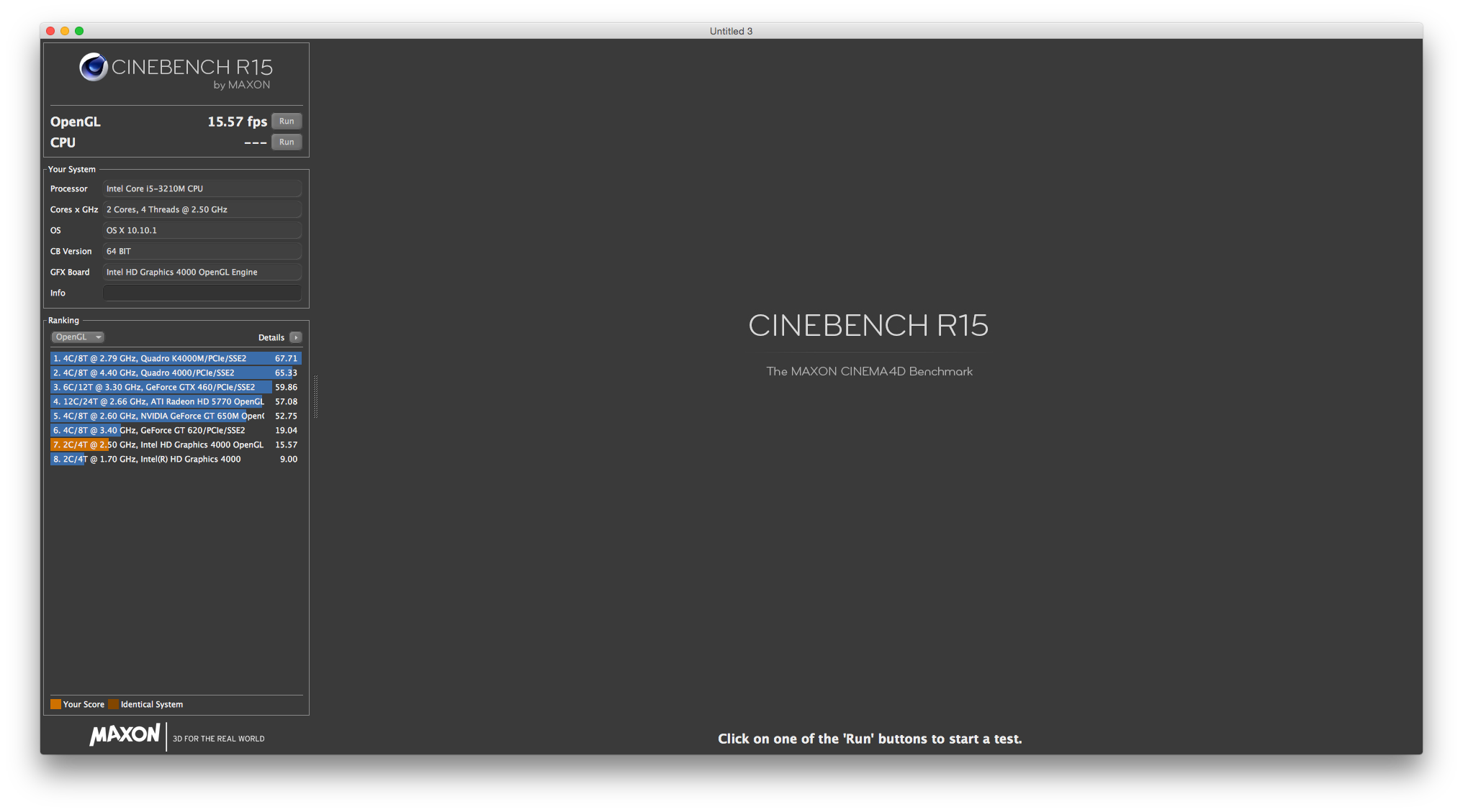

Okay, I've got a Cinebench R15 score of 18.45 for OpenGL. Anyone with HD4000 care to give me a comparison? I'm running the 2.6GHz quad i7 with 8GB RAM. To be honest I didn't really see any of the stuttering during the test so I'm not sure it reproduced the issue.
