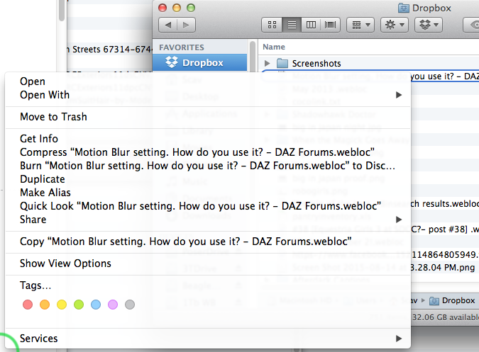

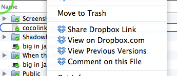

Sometimes the context menu items (share link etc) do not show up when right clicking on items in the dropbox.
The Symptoms:
After starting up the computer, it works fine. Menus are there. At some time(n), they stop being there.
If I quit dropbox and leave it off for some time(x) and then restart the dropbox app, they MIGHT show up again...or they might not. If they don't, repeating that process will eventually work. When they are back, they once again work for some (y) amount of time.
(I'm using 3 variables there because there hasn't seemed to be any correlation between times..completely random as far as I can tell).
Sometimes, but not all the time, the "green check" icon is missing from the files in the dropbox when this happening..sometimes only files in the top level have the check, but any files in subfolders do not.
When all the icons are correct, it seems to work fine. There doesn't seem to be any difference between when some icons are missing and all icons are missing. (I've observed this, but I haven't done any testing to confirm this is in fact true all the time.)

(edit: As I was typing this and looking at the screen shots, the partial green circle in them caught my eye. That's from "Pinpoint"..a program that highlights the mouse so you can find it easier...That is a new install within the past several weeks that does do some direct interfacing with the OS. I've shut it off to explore if it might be causing issues, for some reason).
