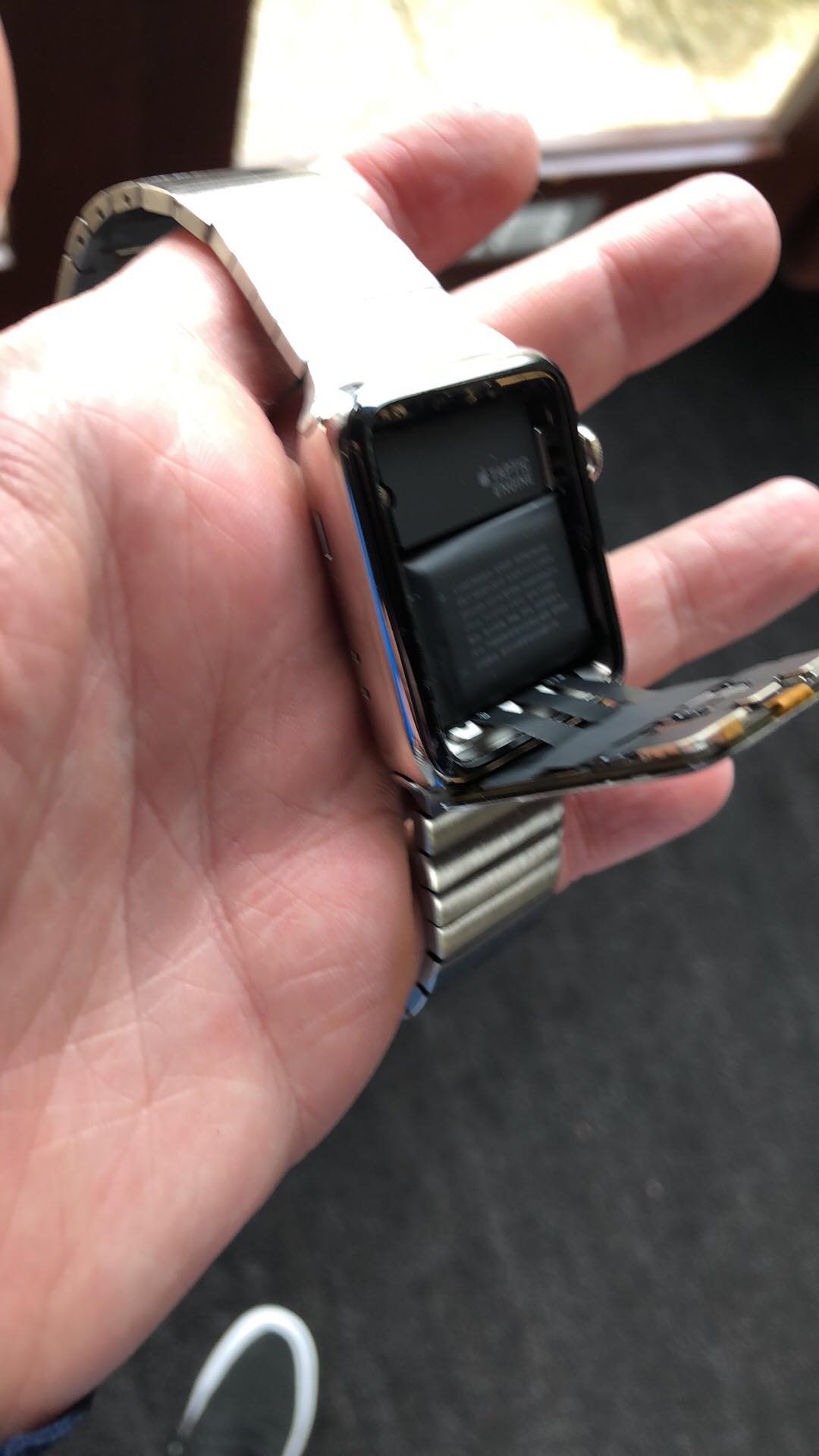

I dropped my Apple Watch at the gym, I removed it to take a shower and it fell to the hard tile floor after opened my locker... this caused the screen to pop off, it's also got a crack on the lower left corner.
The LCD is now completely hanging off, I've tried getting it to pop back into place and maybe living with the crack for a bit but it doesn't seem to want to go back in.

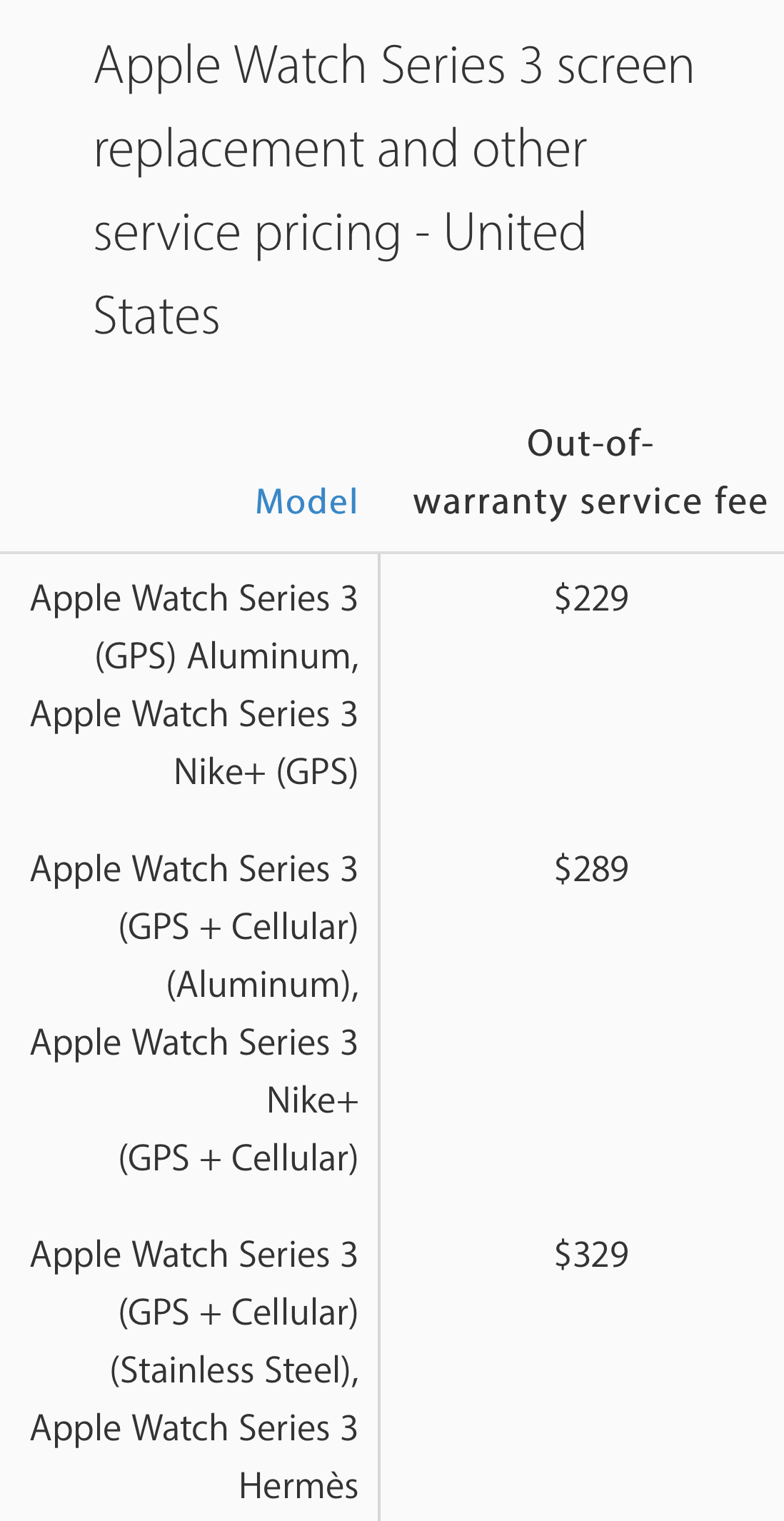

I contacted Apple, it's out of warranty but gave it a go anyway, they said it would cost around £500 (at the most) to fix - they would put a hold on the payment on my CC and then bill the actual amount if I agree for the repair... has anyone been in this position, I just can't get my get around £500 or even anywhere near it.
I also contacted my insurance, and it is insured for accidental damage away from home but with excess, they're worried that it would cost a similar amount to the repair and advised it's not worth claiming (they would say that, but they do have a point).
Has anyone been in a similar situation? Is it possible to get this fixed? Are there any 3rd party repair centres in the UK?
I think anywhere near £300 I could probably pay a little extra for an immaculate pre-owned model, and anywhere near £500, it would be worth considering the Series 4.

I think the cost would be to Substantially higher versus what the watch is actually worth itself. You have to factor the value of the Apple Watch at the time of the repair.
I realize I’m nitpicking, but it’s actually an OLED panel, not LCD.
The only way for Apple to probably repair it, would be replacing the whole display.

My S3 screen cracked when it dropped onto a tiled floor. I visited the Apple Store in Australia yesterday and was quoted about AU$400 for a replacement screen. The Genius person pointed out that it would be better value buying a new S3 with Applecare for about AU$600 (cellular) as the Applecare gives me 2 accidental breakages over 2 years.

I note that the screen has come apart from the bezel, rather than the whole screen falling off.
Take it to a Genius Bar if you can. I have experienced the same. They replaced it for free because they determined it was a manufacturing defect in the adhesive, relating to how the bezel and screen were now two components to facilitate the antenna, compared to the previous version which was a single piece.
